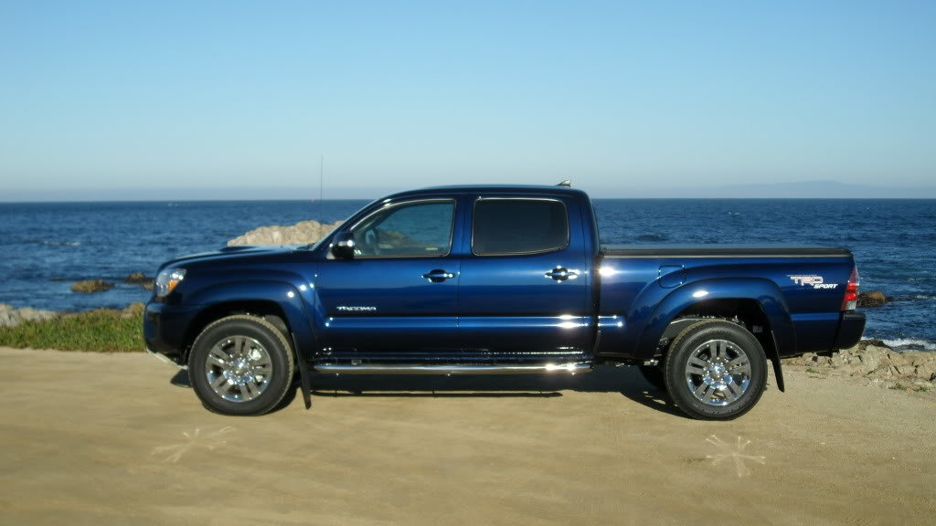

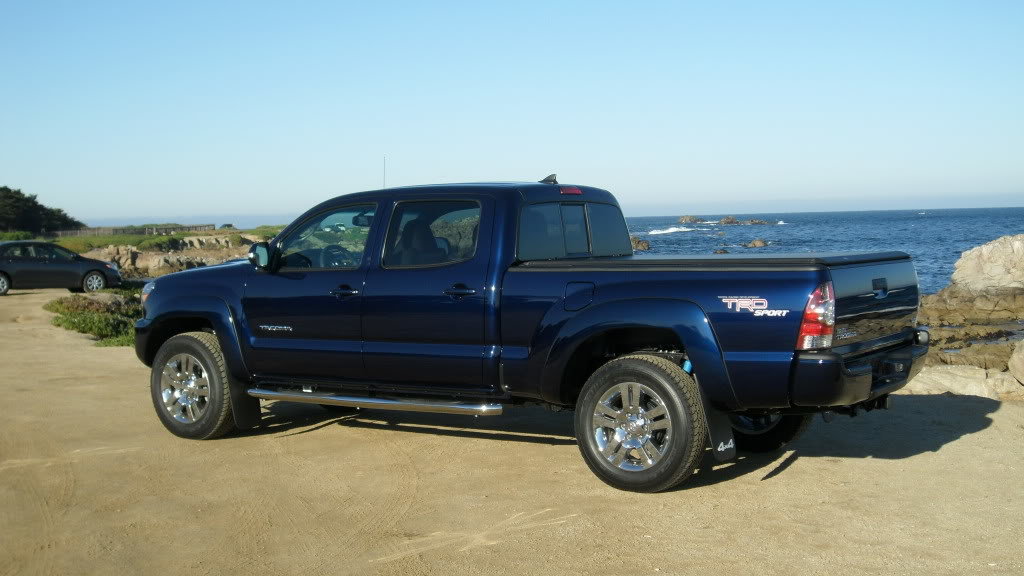

    I pet these on a few days ago. Light and functional, Westin polished aluminum steps.
    I like them, but they were more for my 5'1'' wife who uses them every time she gets in or out. They sit lower than the bottom of the truck, these might be a good option for you.

    Those Westin steps might just work. Seem to sit several inches lower than the steps currently installed on my truck. Do you happen to remember the specific model number?

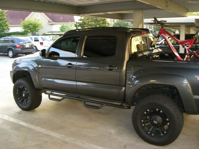

    6" Procomp Stage 1 Suspension Lift, Custom 6" Alcan Springs, N-Fab Side Steps, Husky Floor Liners, Wet Okole Seat Covers, Debadged, Weathertech Side Window Deflectors, 13" Antenna from AntennaX.com, 35% Tint for front windows, Procomp 7032 Series 18x9 wheels, 33x12.50 Nitto Mud Grappler tires
    my friend has the 2012 with the OEM steps and i just installed the n-fab steps. i think the n-fabs stick out a little farther from the body...therefore it is a little easier to get in and out of the truck. the OEM steps are a little closer, but i find myself and others hitting the door edge before actually stepping onto the steps and entering the truck. please correct me if anyone has experienced or feels different about this.

    I've taken a good, hard, look at the N-Fab steps (which probably would do the job, even though I'm not especially fond of the look), but those things are not cheap. On top of that, I'll have to sell the existing steps on my truck at a loss. The combined amount is simply more than I want to spend.

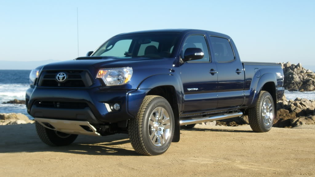

    I have these same steps in black. They are very nice and seem to be more functional than the OEM ones as they stick down a bit further.
