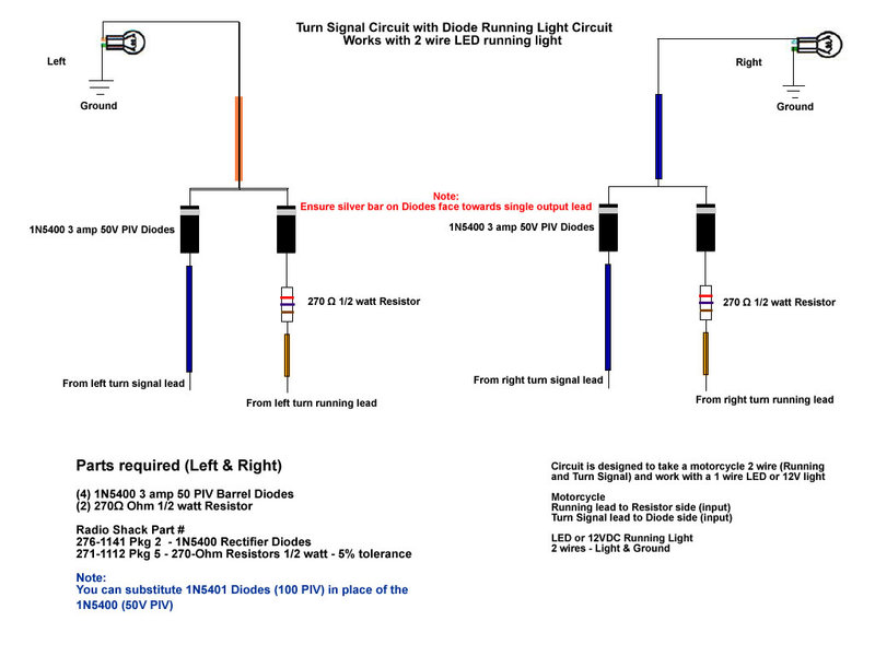

    This isn't the one I was thinking of... this one is older and designed for motorcycles to add running lights to the rear turn signals or to convert from a 3-wire 1157 circuit to a 2-wire LED (like I said, it's old)
    Should work. They will be on dimmer as running lights and brighten to full as turn signals.

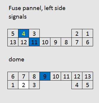

    Turn signals are on pins 4 and 11 of the connector on the left side of the fuse panel.
    Aaand here we go....
    Two circuits required... this shows only one side.

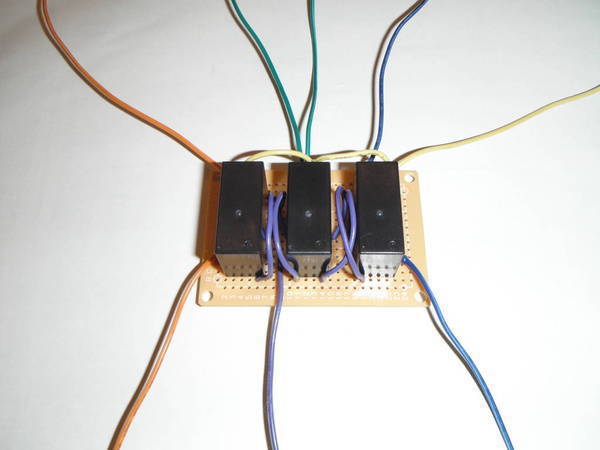

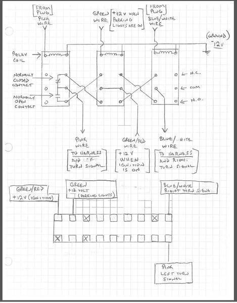

    Ok, I finally got around to drawing the circuit for this so it is readable. You might need to blow it up a bit.
    This modification will regrettably require cutting at least 2 wires. I cut 2 additional wires because I hate quick tap splices. This mod also requires some basic soldering skills and general electrical know-how.
    The parts I used for this were obtained from Radio Shack because it was a holiday weekend and my favorite electronics parts store was closed.
    Qty. 3 275-0243 DPDT Miniature PC Relays
    Qty. 1 276-0149 General Purpose Printed Circuit Board
    Qty. 8 Insulated male and female spade connectors.
    After I drew out the circuit, I soldered the 3 relays to the circuit board with space between them to solder jumper wires. I added a second purple wire after I took this picture but it connects to the same point as the other purple wire.

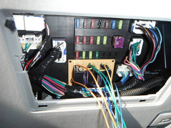

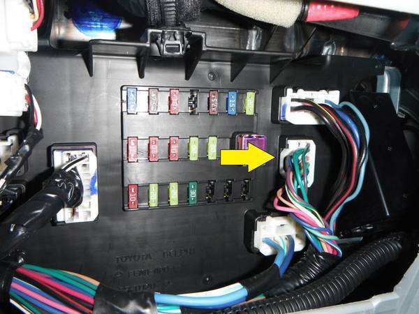

    This is the fuse panel behind the coin tray. The yellow arrow shows the plug with the wires you will need to cut. If you use quick taps, you only need to cut the Pink and Blue wires shown on the diagram.

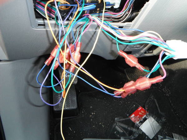

    Before you cut any wires, make sure you have plenty of room to strip the wire and crimp spade connectors. You may need to cut back some of the electrical tape on the wires to give you enough length to work with. You will want to use a male spade connector on one end of the wire you cut and a female connector on the other end. This will allow you to easily undo this modification by simply connecting the cut wires back together. I went ahead and cut the Green wire to avoid using the quick taps. I installed male and female spade connectors on these as well.
    The Pink wire from the plug will go to the coil of the relay for the left turn signal. The pink wire from the harness will go to the common contact of the left turn signal relay
    The Blue wire from the Plug will go to the coil of the relay for the right turn signal. The Blue wire from the harness will go to the common contact of the right turn signal relay.
    The Light Blue wire, on the plug below this (with 3 wires) has +12 all the time. This needs to go to the common contacts of both poles of the center relay. This was originally shown on the diagram as a Red/Green wire which actually goes to the horn...oops!
    The Green wire will go to the coil of the center relay and will turn it on when the parking lights are on.
    Lastly, the other coil wires for all 3 relays will go to ground. I simply connected this to a screw under the dash that was in a convenient spot.

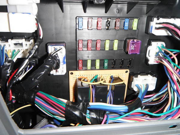

    I mounted the board to the front of the fuse panel with 3M foam tape and tucked the wires in neatly after testing everything.
    The way this works is:
    When the lights are off, the turn signal wires that would normally power the lights in the mirrors now power the 2 relay coils which send +12v from the Light Blue wire to the signal lights through the normally open contacts. The turn signals work normally because when the coil energizes, the contacts close.
    When the lights are on, the center relay in on. This sends +12v through the normally closed contact of the 2 turn signal relays and turns the mirror lights on all the time until the signals are activated. When a turn signal is activated, the turn signal relay turns on opening the normally closed contacts and removing the +12 briefly. This of course makes the lights blink, but "out of phase" from the front and rear signals.
    I have tried to make this as simple as possible to follow. I anyone has any questions, I will be happy to help. :D

  15. Jun 4, 2014 at 7:53 PM
    Rich91710
    Rich91710 Well-Known Member
    Feb 23, 2012
    #73470
    16,331
    Rich
    Los Angeles
    08 Base
    Satoshi with FJ badge, factory cruise, factory intermittent wipers, Redline Tuning hood-lift struts, Hellwig Swaybar, Rosen DVD-Nav
    Clean circuit.
    I drew mine using two relays because I was considering mounting the relays in the doors, so I wanted everything to be self-contained.

  17. Jun 23, 2014 at 12:17 PM
    #17
    delesseria
    delesseria Active Member
    Feb 18, 2014
    #123407
    42
    Tom
    Olympia
    14 TRD Off-Road Blue Ribbon
    ProEFX Heated Towing Mirrors, TRD cat-back exhaust, Snugtop Sport Hi-Liner, Hellwig EZ-990 Helper Springs, IGGYCORP LED pods
    This mod is very nice, but these two sentences are confusing me. Are they correct?
    My truck has the pink wire in the left door for the left mirror signal and the blue wire in the right door for the right mirror signal, but the other ends are not connected to the plug in the fuse box like yours are. Those two spots in the connector are empty. Do you think the ends of the wires are just capped and wrapped up in that bundle of wires at the fuse box? Were else might they have been run? I guess I could just start cutting back the tape and see what I find (ugh, but what mess that would make :().
  18. Jun 23, 2014 at 3:06 PM
    #18
    o0oSHADOWo0o
    o0oSHADOWo0o [OP] Just lurking in the darkness
    May 7, 2014
    #129360
    8,888
    Shadow
    Va Beach
    2012 Double Cab Short Bed 4x4 TRD Sport
    Just a few LEDs...
    Thanks for proof reading this and pointing that out. I just edited that section of the post.
    As far as where the missing wire might be..... who knows?
    It is possible that because my truck is a "sport" that it cam pre wired with a "sport" harness which included the wiring for the mirrors. An Offroad or an SR5 might not have the same harness.
    By the way, I will be making an addition and update to this mod soon. I found a way to insert an LED strip inside the clear lens on the mirror housing. I'll post pics and a full writ-up when I do the other side.
