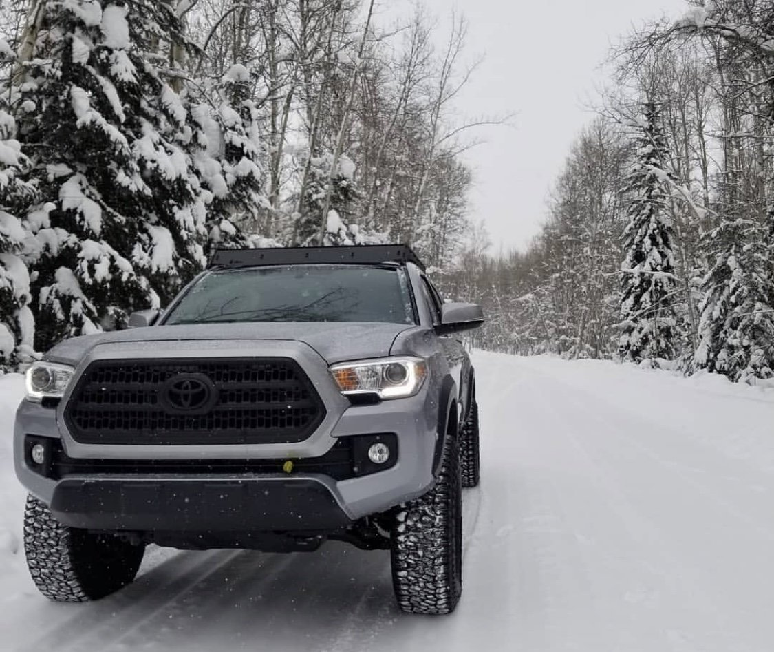

    No rub. Didn’t even have to cut anything. I am However Using spidertrax wheel spacers.

    how do you like the spacers? Any pro's or cons to them? I picked up my 2017 pro this week and like the look of the stock rims but want them to poke out of the wheel well a little and am not sure if I want to do spacers or not. I plan on installing LT 285/70/17 TA/KO 2's but have mixed feelings about the rims. I was thinking about wheel spacers or a -12 offset, and found rims that I like with that offset, but dont want to ruin the bearings or have rubbing. I do some mild offroading and camping, but mostly use it on the road.

    Agreed. Really like that combo.

    they’re good. Ran them for 60k miles and never really had an issue. Wheeled the fuck outta mine too.

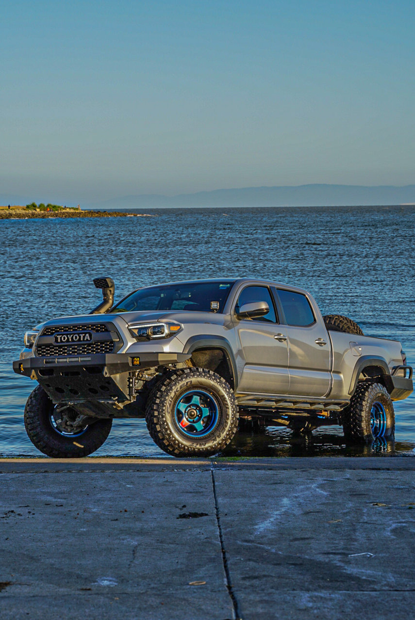

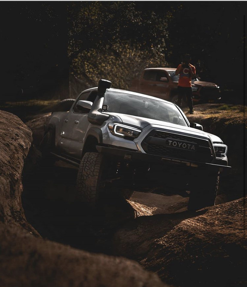

    Either way. I graduated from 285’s and now on 315’s. FC088E3D-76FD-4F3B-85E7-BA3B7729BCCA.jpg
    Have fun here guys.

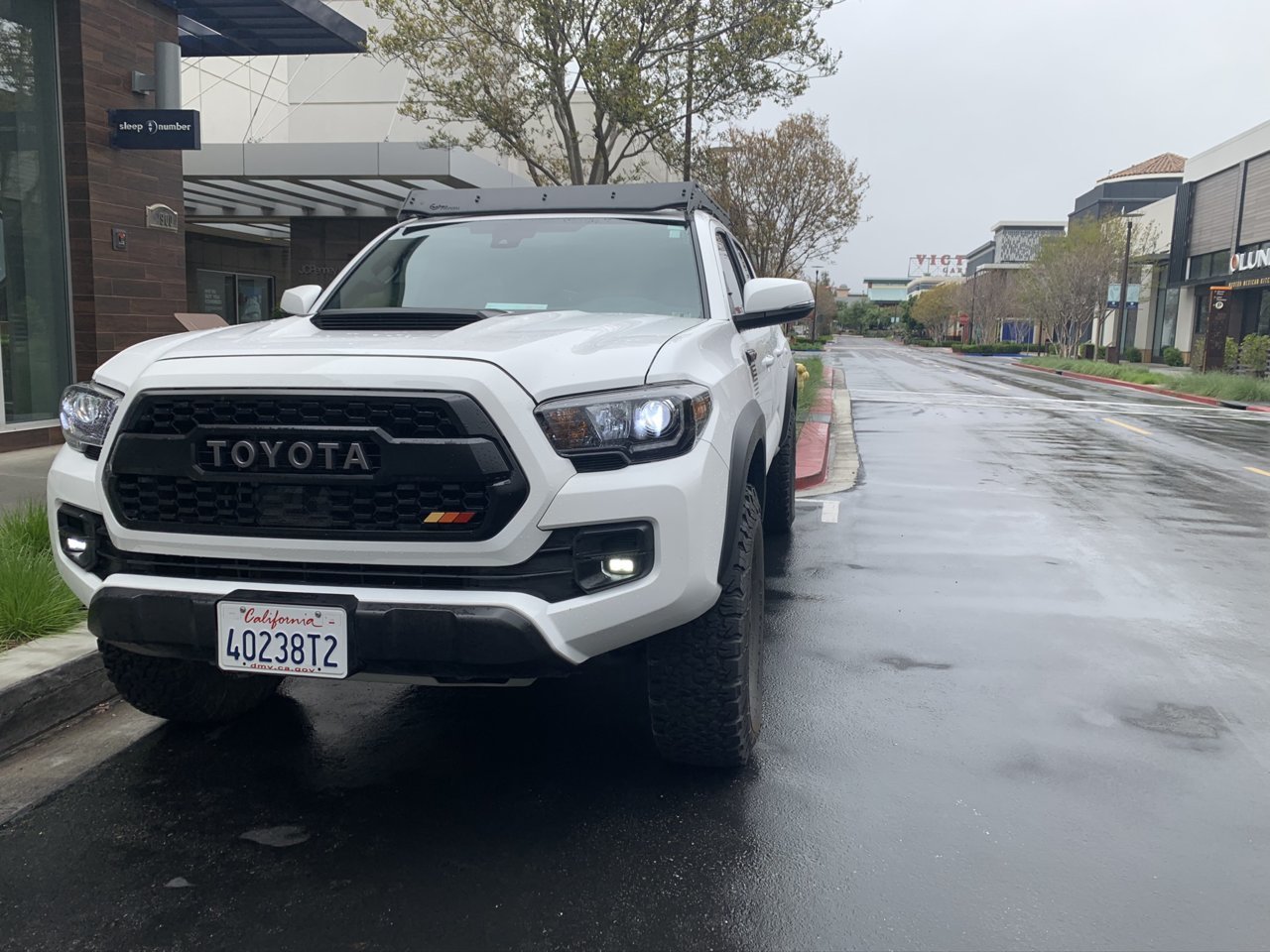

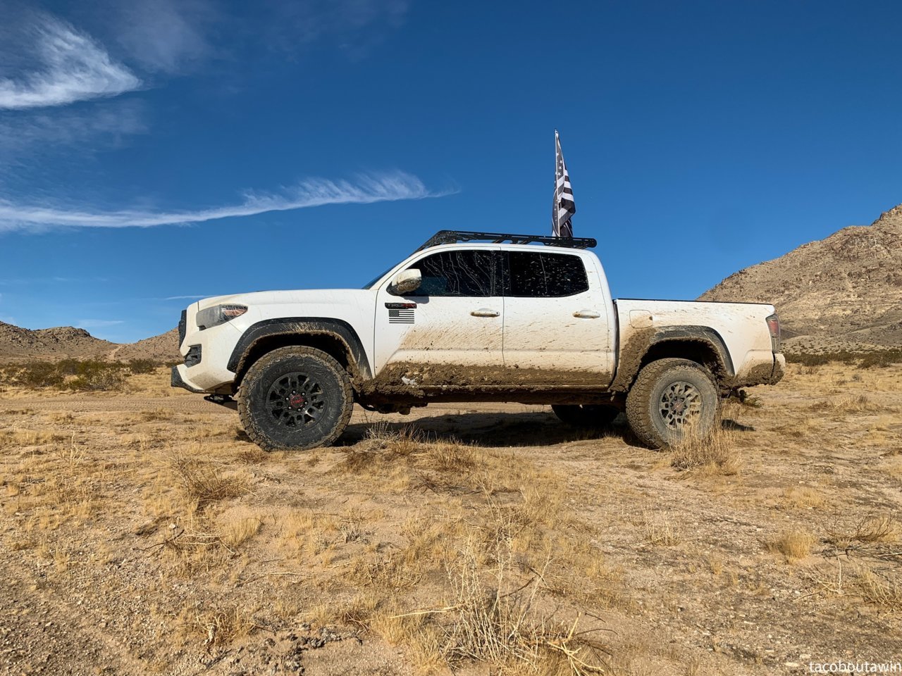

    Stock pro suspension so about a 1” lift as of right now. A very small amount of rubbing when going in reverse and wheels cranked.
    KO2 285/75/16 - no spacers
    New 2.5 coils arriving this weekend which was a decision mainly for off-roading. Small rub on streets wasn’t a huge deal to me but to each their own.

    In reality the spacers will not ruin your truck. Not immediately at least. Keep in mind i have 64,600 miles now and just recently took my spacers off. Had The spacers on since mile 5.
    i drove all the way from San Diego to the mountains of British Columbia all the way through Deadhorse Ak. On the spidertrax wheel spacers. If that doesnt give you enough confidence... then dont throw them on.
    I did it for the stance too. It looked fuckin sick with the little bit of poke.

    You rocking the falkens here? Like the stance it gives with the spacers

    Yezzir

    I know you mentioned that you had the spacers since 5 miles did you get them for the stance or to fit the 285’s

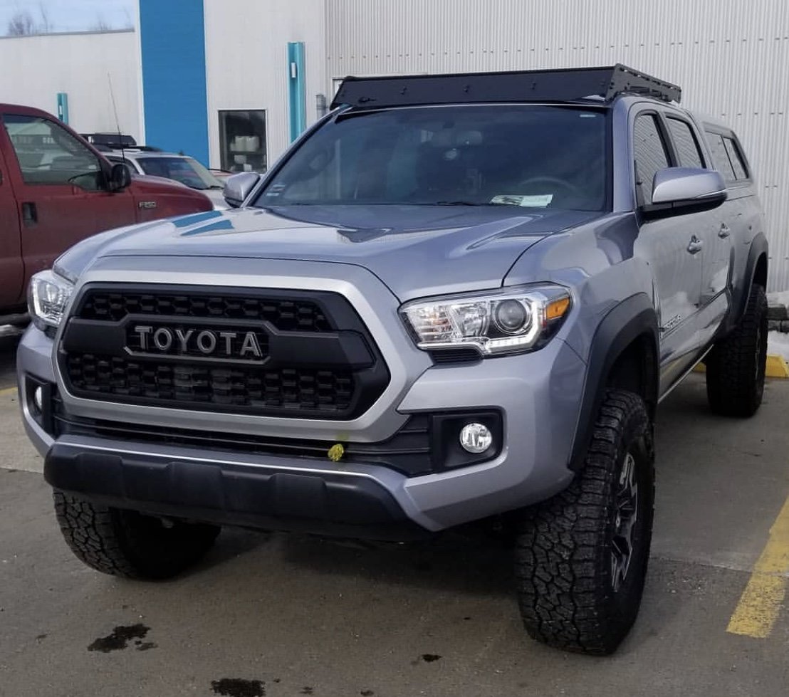

    I got my lift off headstrongoffroad.com. it's a 2.5" old man emu with 886 front coils and hs 3 leaf add a leaf in the rear (left the overload spring in). I also added 1/4" spacers on the front to get the full 3" of lift so the truck sits level.
    Revtec diff drop
    Old man emu carrier bearing drop kit
    Jba upper control arms.
    Replaced the needle bearing with the ecgs clamshell bushing while everything was apart.
    1 1/4" Spidertrax Wheel Spacers
    Tires are 285/75/16's.
    Truck rides smooth and doesnt rub at all. Didnt have to do any trimming just took the front mud flap off.

    do you have any pictures down the side of the truck? I am wondering how much the tires poke out the wheel well without playing with the spacing. I was planning on doing the revtek 427AP 1.5" lift for the pro that keeps the stock suspension and might be keeping the stock trd pro 16" rims... still playing with ideas

    Stance. And to be safe.. i didnt wanna hit my tire on the UCA. So the spacers pushed them out too

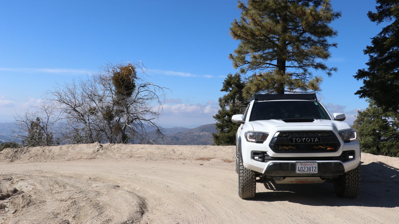

    Only two as of lately that I have. I also have 1.25” spacers which aren’t installed yet that I would recommend. That or a small negative offset

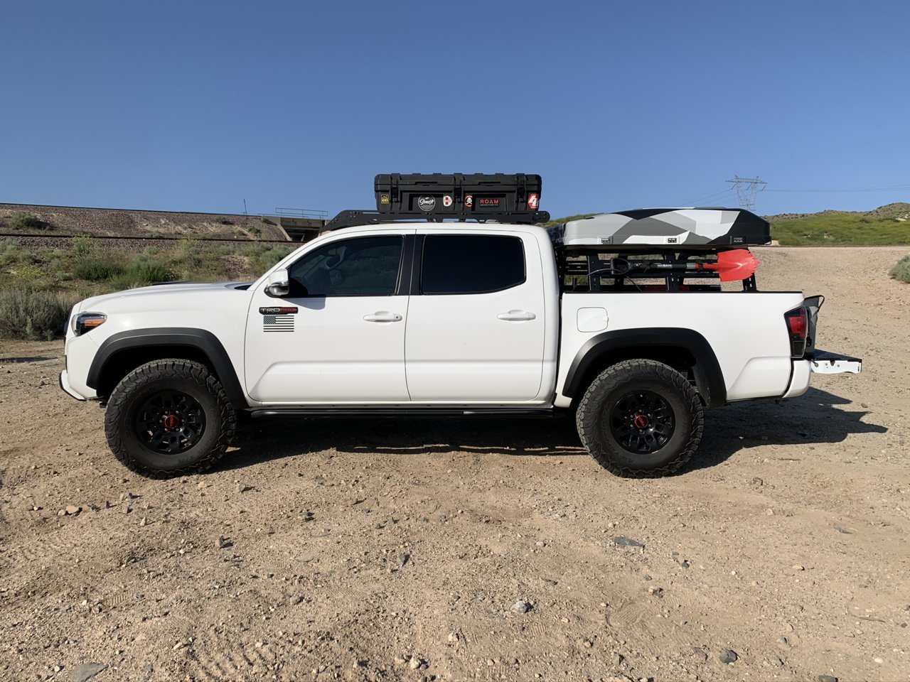

    I have 17x8.5” wheels with 0 BS. 285 70r17 Ridge Grapplers. SCT upper arms and 3” of lift. Rubs only the factory mud flaps.
