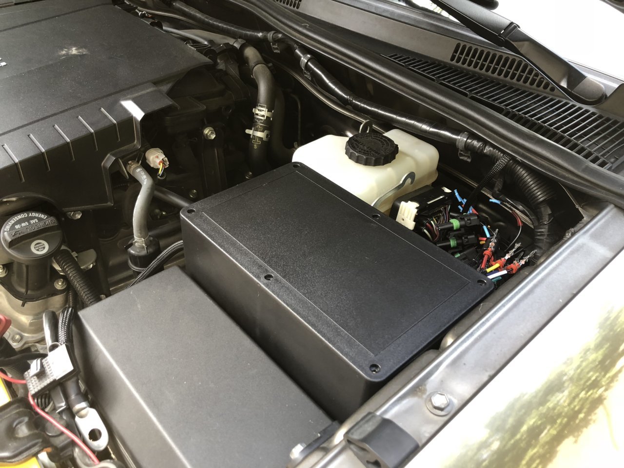

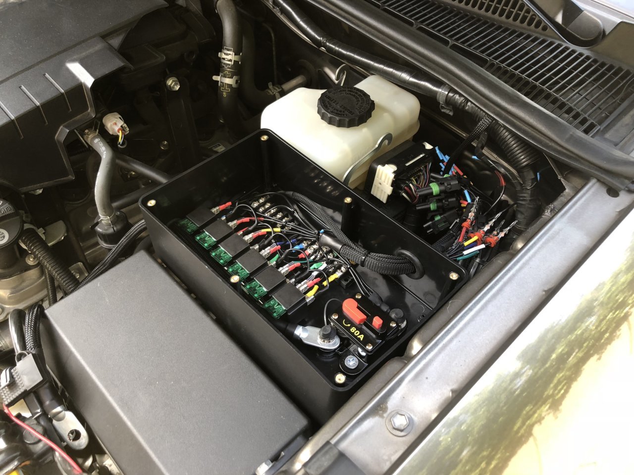

    Decided to build one myself. There is just enough space to get the factory fuse box cover off, and you kinda have to reach underneath the Aux box to reach the smaller fuse box to get the cover off, but its double. (but how often do you need to get there anyway...;))
    I used this company as a reference in building the aux fuse box. They build custom fuse panels for automotive purposes.
    https://ceautoelectricsupply.com/custom-relay-panels/
    Another reference I used was this thread.
    https://www.tacomaworld.com/threads/diy-build-and-install-a-bussmann-rtmr-fuse-relay-block.399454/
    I first needed to find a electrical box that would fit nicely in that location in the engine bay. I also wanted to keep it as factory looking as possible. Another consideration was waterproofing and dust proof. The box cover has a gasket which helps.
    https://www.amazon.com/gp/product/B005T5AQPA/ref=oh_aui_detailpage_o01_s01?ie=UTF8&psc=1
    And the rubber grommet which the wires comes out of the side of the box is pretty tight. Its not waterproof per say, more water resistant. If your looking for a "full" waterproof option I'd go this route for running the wires.
    https://www.amazon.com/dp/B0748JLNR...aH&pd_rd_r=QVPQ4M0CHW2QEKSSVMDB&pd_rd_w=vRdWh
    As I wanted to keep this as watertight as possible. I chose to get some of these wire connectors. Which adds a level of safety and reliability. Also makes if very easy when I might ever need to disconnect this system. They make everything from 6pin to 1pin connectors. I opted for the 2pin and 6 pin for my build.
    https://www.amazon.com/gp/product/B00QTE0PZ6/ref=oh_aui_detailpage_o00_s00?ie=UTF8&psc=1
    I wanted everything electrical to be within this box so space was limited. So I opted to try out these automotive relays which have fuses incorporated in them. They are rated up to 30AMP (which is just fine for the type of Acc ill be running). I chose these instead of having a separate fuse block, just to eliminate more wiring and fuses.
    https://www.amazon.com/gp/product/B01NBAO1SA/ref=oh_aui_detailpage_o01_s00?ie=UTF8&psc=1

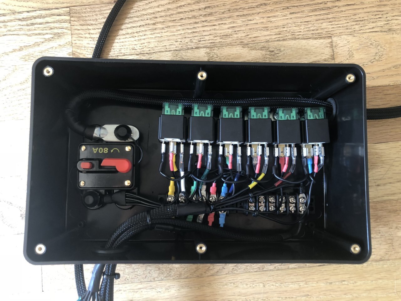

    Of course another safety feature which you see other members use is a 12v 80amp circuit breaker. I have this mounted in the Aux box and have a 4G wire coming from this out of the box through a grommet to the battery. Blue sea makes a very nice one of these, but a generic one might do the trick such as:
    https://www.amazon.com/gp/product/B01CZDY4JW/ref=oh_aui_detailpage_o01_s00?ie=UTF8&psc=1
    Within the box is two 8 pin bussbars which all my acc wires connect too and ground wires. The wires then continue out of the box to another 6 way plug where I can individually plug each acc wire and ground wire into (such as roof LED or bed LED). Also coming out of the box from the relay are 5 hot wires for my switches that are located inside the truck in the console.
    https://www.amazon.com/gp/product/B000A770HO/ref=oh_aui_detailpage_o01_s00?ie=UTF8&psc=1
    Mounting the box was relatively easy. As there are two mounting bolt holes located in the engine bay right where the box is. To make sure the box is extra secure I made a "Z" shape bracket out of 1/8" thick metal about 1" wide located on the outer side of the box. Which is mounted to the factory bolt of the fuse box and on the underside of the Aux fuse box. (picture will explain better...)
    Feel free to PM me if you have questions. My apologize if this is confusing at all...

    Very clean. Looks great! Does each relay have it's own fuse attached?
    4T3Underhill[QUOTED] likes this.

    I'd say yes, look at the green dohickeys by each relay.

    I think it looks exceptionally clean. Very nice job! I would encourage you to share the information in this thread. It will probably save you a lot of individual replies and I am sure many members would enjoy seeing the information. If you are not willing to share it in this thread then I will start a PM with you to find out.

    Yes! I was kinda skeptical on them. But after seeing reviews and such on youtube and other members I bought them. They are great and free up some space which was nice. They are rated up to 30AMP.
