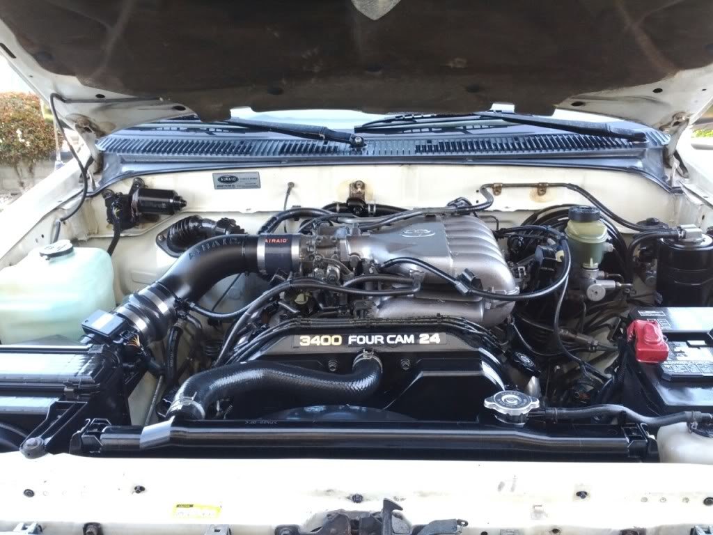

    While waiting for money to show up for the engine to be completed, I'm starting to plan all the other mods to help get the most out of the S/C when its all back together. So just wanted to see what others have done, like what injector you guys run to make the most out of the s/c.
    My plans are to get an older Tacoma washer fluid tank and put it up on the passenger side wheel well where the ABS would be if i had it... then a kit of sorts or a DIY with a factory washer pump from a vehicle with headlight washers.. (should be a 75 psi pump in most cases)

    This is the tank i'll be using most likely..

    97 reg cab, v6 5sp 300hp supercharged, Methonal Injection, 800,001 plus miles, Original Owner
    V6 5sp,RegCab,TVS1320 Supercharger, 56mm pulley, methanol injected Haltech ECU, AC Tvs1320 supercharger,(MUST DO) every 125,000- 150,000 needs rebuild Projector headlights HID 5 speed manual Amsoil for all drive train Smaller 56mm custom pulley, (MUST DO) 2004 DESNO fuel injectors, zero ping ping, 2004 side door mirrors Dick Cepek Rims, Michelin tires LTX, ATM Pathfinders Dynopro ATM ( that last 100,000 miles) Now running Dynopro ATM mud and snow tires KN cold air intake Cat back dual exhaust with ss exhaust tip, Raised exhaust tail pipe to 2" below body line Optima*dry cell battery,red top Alpine sirius radio, 200 watt amp, focal is165 split door pod speakers Focal door speakers Subwoffer behind seat Viper alarm, Electric Locks Dark tinted windows, bucket seats corbeau lg1 Tacoma Rubber floor mats TRD fender extenders, Bilstien shocks, King shocks JBA UCA trailer iv hitch, electric brake control, Drilled slotted brakes, High carbon steel (MUST DO) EBS green stuff 7000 series pads(MUST DO) TRD engine oil cap TRD stick shift, Marlin crawl shift kit. Rear sliding window 2002 4Runner functional hood scoop cut into Tacoma hood, 4Runner dual overhead map light Gentex Auto dim + Compass + Temp, garage,rearview mirror Snow Methonal kit stage 2 Custom 3 core aluminum radiator Linex bed liner Haltech stand alone ECU, Intake supercharger gauge. Stainless steel brake lines, Custom leather wrapped steering wheel, Haltech stand-alone ECU,
    I've had the system on for a week driven 800 miles and driving in 100 plus degree heat, I also see
    the advantages of not having a heat soaked supercharger from this kit anymore.
    Now that I've got this system installed, (I was on the fence before) I just don't know why there aren't
    a lot more people out there that have superchargers with this system. When I was on the fence
    I could only find a hand full of people that had a system installed for the TRD supercharger, more
    for the turbo people. It's an inexpensive setup, 475.00, for a progressive kit, and has a ton of benefits.
    No need for a intercooler, this kit addresses that.
    A set of headers and a cat back system would cost
    you more and you would get a marginal return.
    For those of you with ping issues with your supercharger or those that want a smaller pulley
    I totally recommend this kit to eliminate the ping and fuel issues without added and piggy back system or 7th injection kit or fuel pump upgrade. Of course my setup is at 5500 feet so sea level
    would be different I think, maybe not? If you had a piggyback system then you could play with the timing and get even more power also.
    Super clean system all installed, highly recommended over the 7th injection system and very inexpensive and easy to install with more benefits.

    #113940
    10,365
    John
    Denver
    Stock injectors, 2004 motor, the methonal will raise your octane up to 110-115 if you use 50/50 mix.
    You can set the spray progressive kit by the rpms or by the boost, each engine will be a little different depending on what's needed and what size nozzle and what your runnnig, mine I'm running a 2" pulley and without the methanol I would not be able to use that pulley. I get an extra pound or 2 out of the smaller pulley. Each boost pound adds 10 degrees of heat, 10 pounds adds 100 extra degrees, the methanol kits can lower supercharger temps by 100 degrees, my AFR gets out of sync at 5 pounds, so that's when it's starts to spray up to the limit of 10 pounds keeping my AFR PERFECT. Each extra boost for me is about 15 horses. So 2 pounds is about 30 more horses.
    If your not adding a lot of boost and your AFR is ok, then no need for the methanol kit, unless you need
    to cool the supercharger down,
