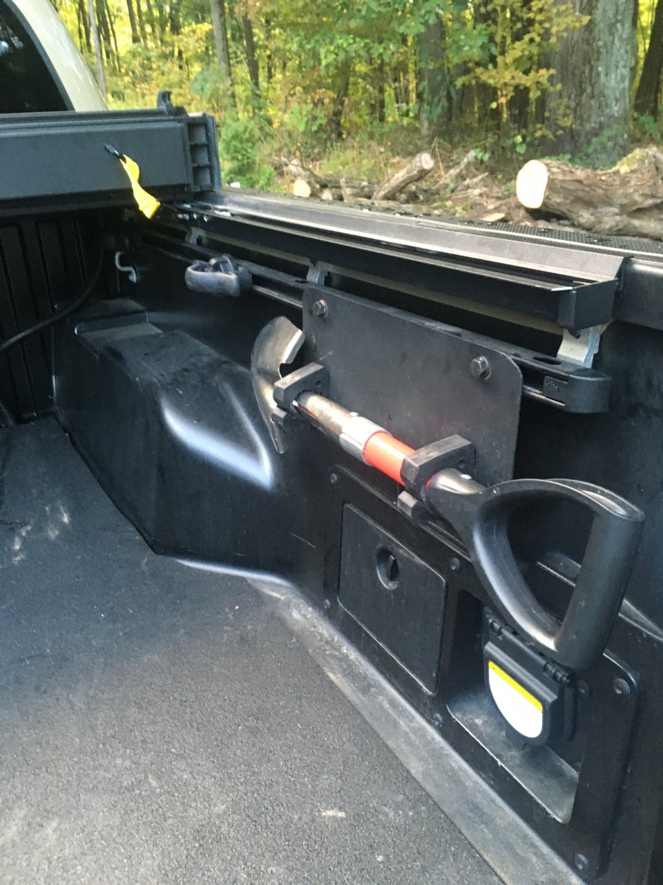

    Homemade quickfist brackets for the factory rails.
    Materials are strut nuts and a piece of 1"x1/8" steel both from home Depot.

    This is what I did also. Although I found some 6” brackets with a 1” bend at the hardware store and used those. Same idea though. Biggest thing is get the quickfist and then making brackets is pretty simple

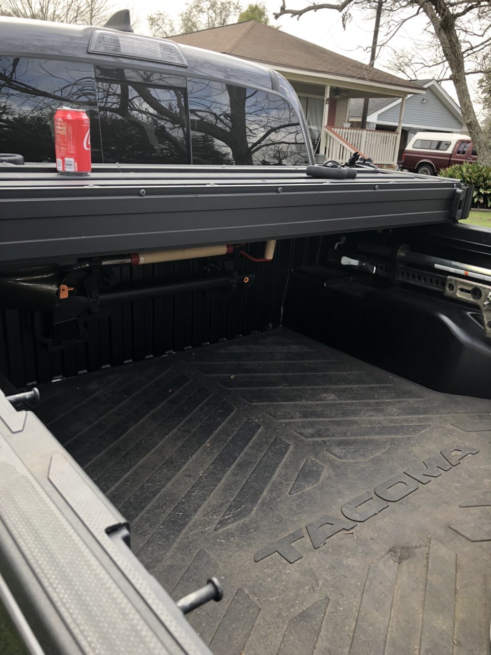

    Got Quickfists and T-nuts from Amazon, easy fab of a couple of steel straps and rubber bottle stopper as shock absorbers.
