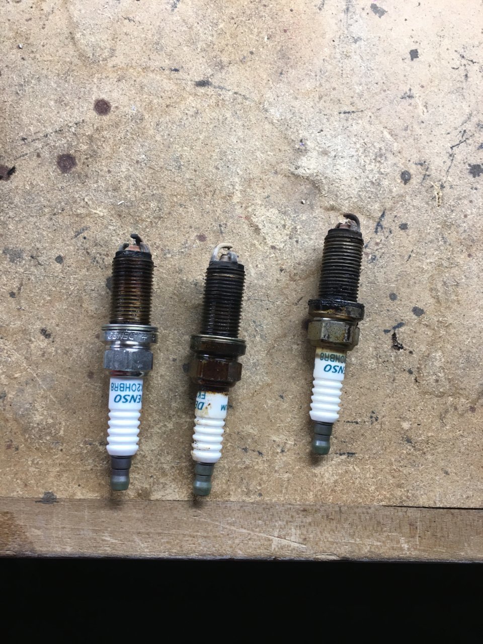

    I just did my first spark plug replacement on my 2017 Tacoma. I found in the process that two of the spark plugs were lose when taking them out. Oh that sinking feeling when I braced to break the plug lose and found no resistance...... The coil pack for those two plugs was very discolored. I am attaching a picture for reference. I am also attaching a picture of the plugs. I will let you figure out which coil packs and plugs were the lose ones :) My question is should I replace the coil packs or is the discoloration just cosmetic? Thanks for any insight or feedback!!!!

    This is like the third or fourth report of loose plugs. After the first couple, I got spooked and checked mine. All were good other than the feeling of the dry threads. Some antisieze fixed that.
    I don't know what the test measurements are for the packs. You might look in the Service Manual?
    If it was running fine otherwise, I would just continue to use them.

    Thanks!!!! It runs fine (and did even when they were loose). I might just bite the bullet and do the replacement and then keep the 4 that are not discolored as my backups. I can say for sure I will be checking the plugs tension more often then every 40k now :)

    Yeah, this. No driveability complaints then re-use em.

    Buy a service manual.
    Buy a multimeter.
    Test the resistance as specified in service manual.
    Then you'll know whether or not you need to waste several hundred dollars on new coil packs.

    With an ohmmeter, you can read the resistance on the good coil packs and use as reference (if you don't have a manual) to see if the other ones are within range..
