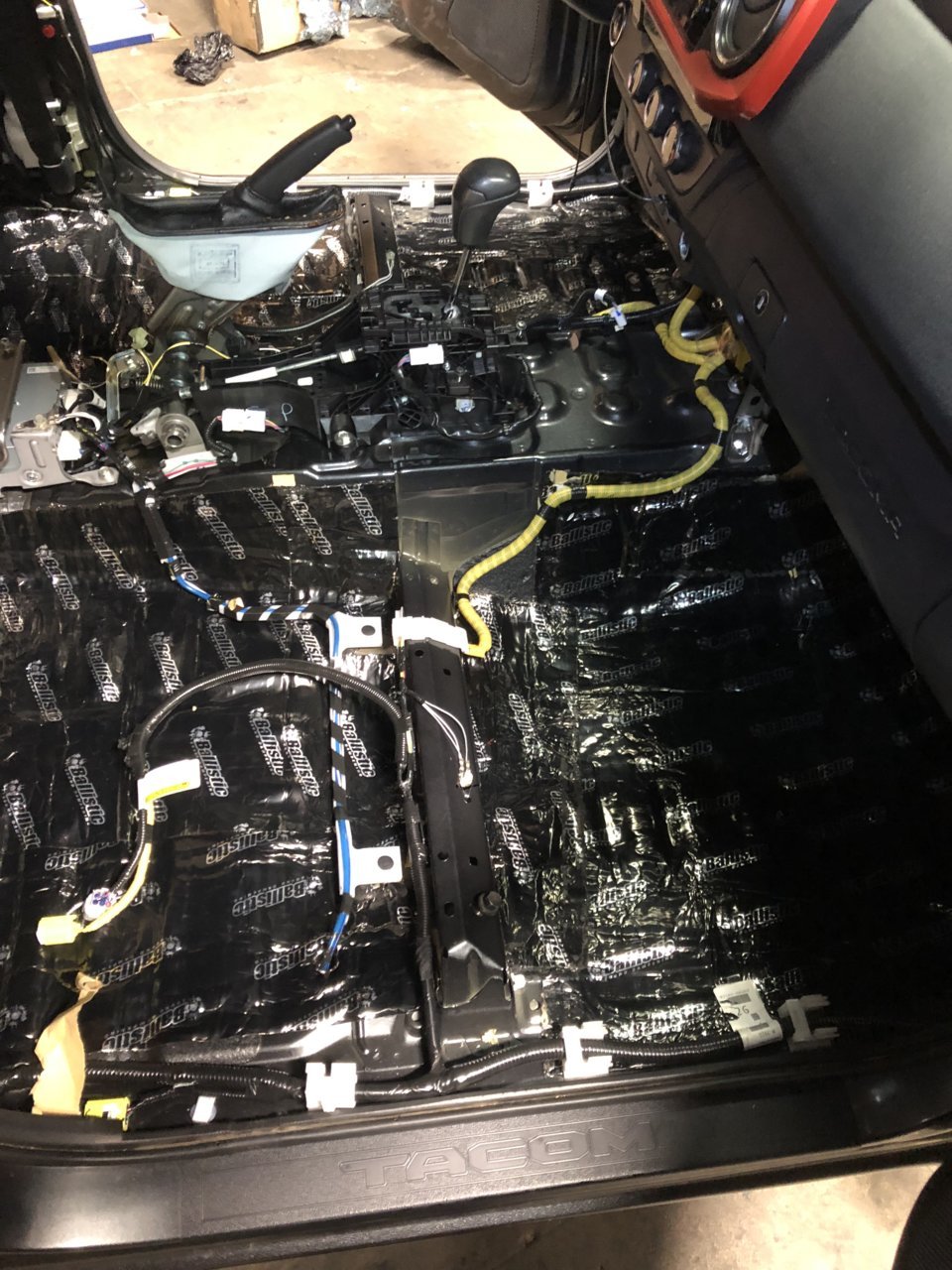

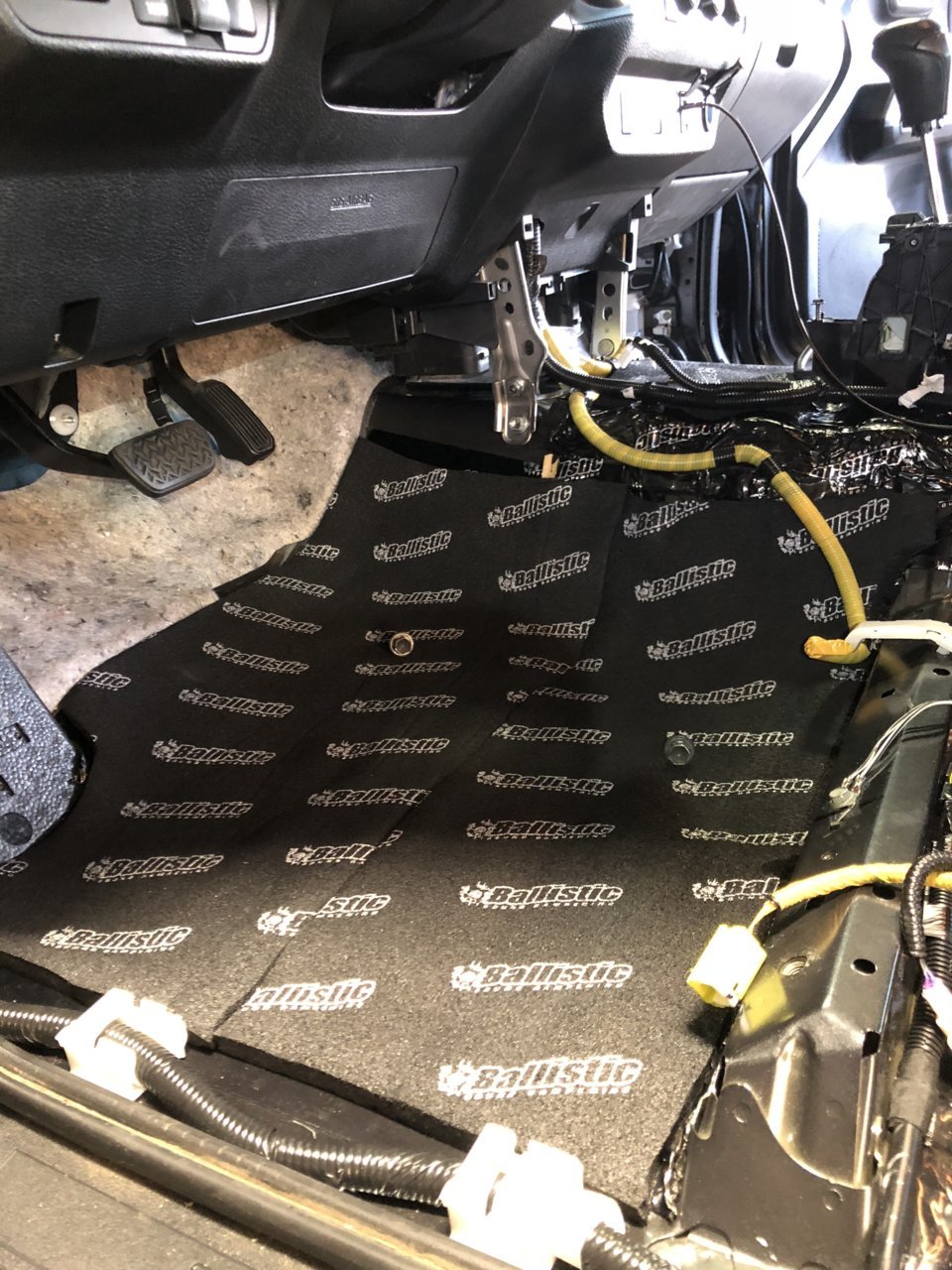

    I have put in Racesport gen3 leds I'm the process of doing a custom audio overhaul which will include Hybrid audio unity 6x9 mid bass, unity 3 inch mid driver in the dash and fiberglassing tweets in pilar soundeading all the doors, floors, and headliner and I will be using a helix processor to retain the factory radio and as far as subs I might make custom brackets to move rear seat foward a few inches to get a full size sub in there or I might just go with a pair of jl tw5 or tw3 and it will all be powered by jl audio HD amps or I might try out the new hybrid amps
    It really depends what your goal is! If your doing it primarily for rattles and road noise do inner outer layer if your go is making your car as quite as possible then do both layers plus some on the door panel it itslef! I’m building a sq sound system and I did my entire truck two layers of the thickest ballistic on the outer layers, one layer of ballistic on the inner and another layer of soundskins pro on top of that! I did the floor board with ballistic followed by a 3/4” closed cell foam layer then factory matting and carpet I did the entire headliner with soundskins pro and two layers on tbd back walll one ballistic and one soundskins pro. And my truck is quite as F*** and it sounds like a tank when you close the doors!

    What kind of material do you have on top of the butyl mat in the second picture? Is that a closed cell foam? How thick are all your layers and how do floor mats etc fit when you stuff the floors with all the materials?

    Yes it is closed cell foam. It’s 1/2 inch thick the butyl layer is 2.2mm which is about 86mil thick. I also put the factory padding on top of the ccf and then the carpet it was a pain to get the carpet on but it fit just a little struggle. But my entire truck has has later if butyl and closed cell foam and it is sooooooo worth it all my cars get the same treatment!

    Seeing this makes me a bit jealous. I don't have the time or resources for this type of job and I'm willing to bet the results are amazing. When I can, I will add more CCF and MLV.
