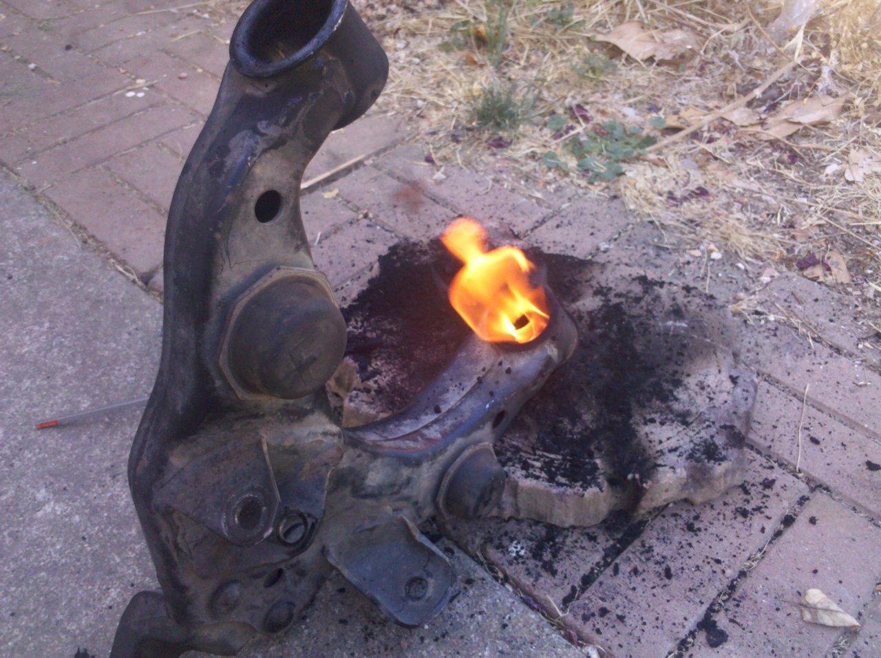

    You can get a full set of energy suspension poly bushings for about the same price.
    There are good and bad to poly. They give you a more precise steering feel, but they do tend to feel more "harsh" because they transmit more road vibes (less "give" like rubber).
    Also, of you don't have a press, the ES poly bushings are a fairly simple DIY install.
    You burn out the old rubber, clean it up, and push in the poly.

    Yes my mechanic said he didn't have a press. I should mention the burn out method. Although he likely won't consider that method as its very messy. As a mobile mechanic in California torching this might raise some eyebrows. :hattip: He said he plans to buy the press this week.
    Also this is good to know about the pros and cons of poly. Is the vibration that noticeable, is it annoying? Dumb question, When you push them back in I presume the LCA assembly has to be off the vehicle right? Lol - I wouldn't assume you could torch them out and push them back in while everything is assembled right?
