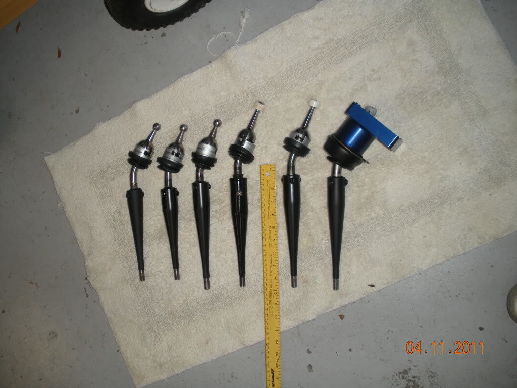

    I had wanted to modify my shifter in my 6 speed for a shorter throw, so I purchased a Short Shift kit from URD. The SS was great, but my stock shift lever was worn out. The rubber bushing inside the two piece shifter had degraded to the point where you could wobble it really bad while it was in gear. I had done some searching around to see if anything could be done about this, and stumbled upon the X-runner forum and a member named Coupe. He had a thread on the XR-U for his modified shifters that was very detailed with great pictures, and step by step instructions. He is also a member on TW, by the same name, so I contaced him to ask some questions about his mod. After realizing that purchasing most of the materials for the mod would probably run me somewhere around $100, I decided to buy one directly from him. He charges $120 shipped plus your stock shifter in return. I thought this was a good deal, and turned out to be so. The shifter I recieved from him was cut down to 9 1/2", and solid as a rock, with little transmission noise coming through the lever. Now with the URD SS and one of Coupe's shifters, my truck drives/shifts like a dream. This combination cut my shifter throw to less than half of what it was! There are no issues with rough shifts, or hard gears to catch (like reverse). All gears catch perfectly crisp. If your shifter is sloppy, and you would like to experience clean gear engagement again, look up Coupe. He has a few different kinds of modded levers to choose from, so take your pick. Very easy to do bussiness with, and a great product. Thank you to Coupe.

    Here is a link to the original write-up.
    http://www.xr-underground.com/forum/showthread.php?t=31063
    I can do this mod with a TRD SS and a B&M.
    This pic shows an array of shifters.
    From left to right,
    8 1/2" OEM mod, 8 1/2" OEM mod, 9 1/2 OEM mod, 9 1/2 TRD SS, 9 1/2 TRD SS, 9 1/2 B&M.

    Above the fulcrum point of the shifter (i.e. the part that sticks up from the tunnel) if you lower the top of the shifter you will have shorter throws of the shifter.
    Below the fulcrum point of the shifter (i.e. inside the transmission) you want a longer tip for shorter throws. This is how an URD short shifter works.
    Before I put a T-56 transmission in my truck, I used a combination of these two approaches.
    The pros:
    Shorter firms shifts.
    The mod I do to the shifter will pretty much last. The stock rubber bushings get removed which will fail after a few years. When you remove the soft parts from the shifter, the "feel" of the shifter gets better.
    The cons:
    If I do my mod, the shifter will be noiser, especially at wide open throttle.
    Just doing the URD will not have this problem.
    Since you are reducing the leverage of the shifter, it will be more difficult to put the shifter in reverse. A petit woman may have difficulty doing this. My wife can do it, but she drives a Z06 daily.
    There is a slap technique that works well for putting it into reverse. You slap the shiftball in the direction of reverse and it will fall into reverse.
    It will take a few tries to get the technique down. Service people or valets will struggle with it.
    Just a FYI if you go looking for a shifter to do this mod, the shifter for a 2wd is different than a 4wd. The curve of the top portion of the shifter is different.
