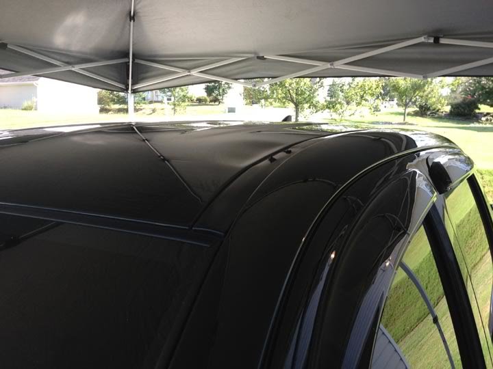

    I'm not sure if people put the rubber things back in the roof channels, but I don't like the look of it without them, so I cut them up and put them back up on top with a lot of silicone to hold them on. Probably overkill, but again, better safe than sorry. Cutting them only required a sharp knife and twisting the rubber thing a few times to break the wire in the middle, that's the best way that I found to keep the edges clean and to not have part of the wire poking out.
    When cutting, it was a little under 7" on the first piece, 19" on the second, 15" on the third, and then 3.25" inches from the back of the rubber piece (not including the tab that slides under the rubber part that goes down the back of the cab) on the last piece.

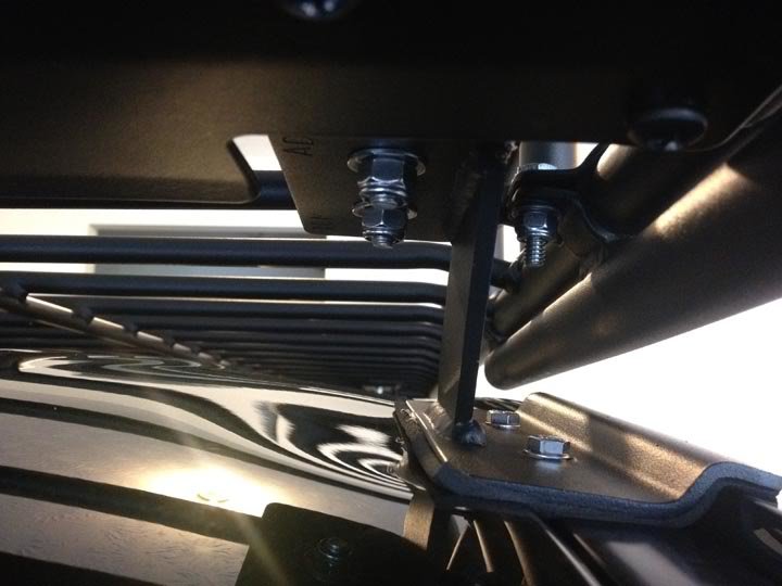

    The sherpa may be a tad wider, but nothing too noticeable in my opinion. The rack mounts using the cross bars rather than the outside like the prinsu rack does.

    Keep an eye on those brackets - they look pretty close to the sheet metal.. almost potential for a Baja Rack Situation going on..

    Just looked on the truck and I think it was just the angle at which the picture was taken. They have about a quarter of an inch in between the sheet metal and the mounting brackets.
