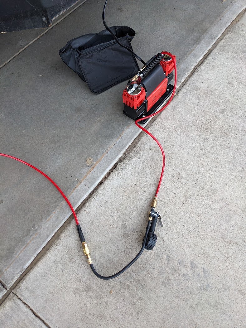

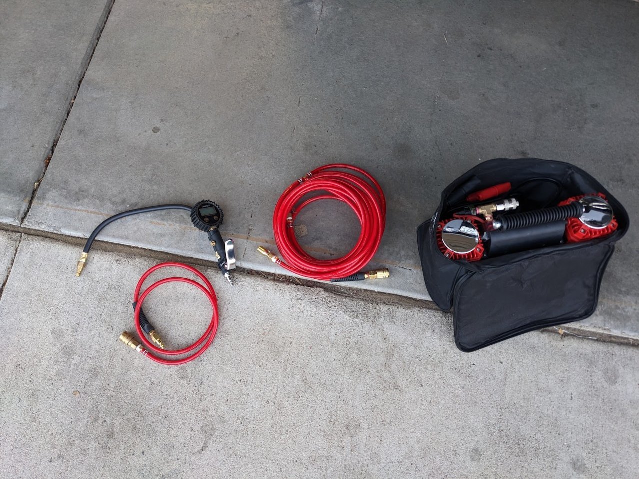

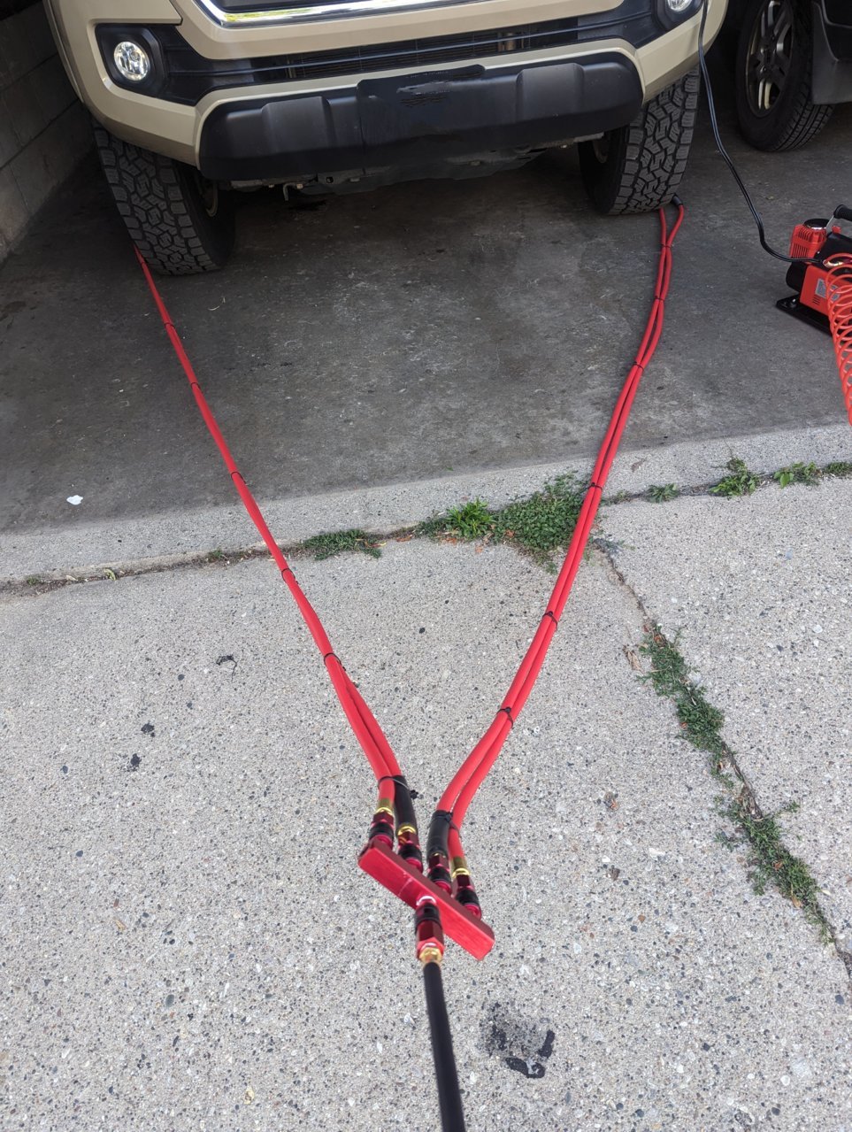

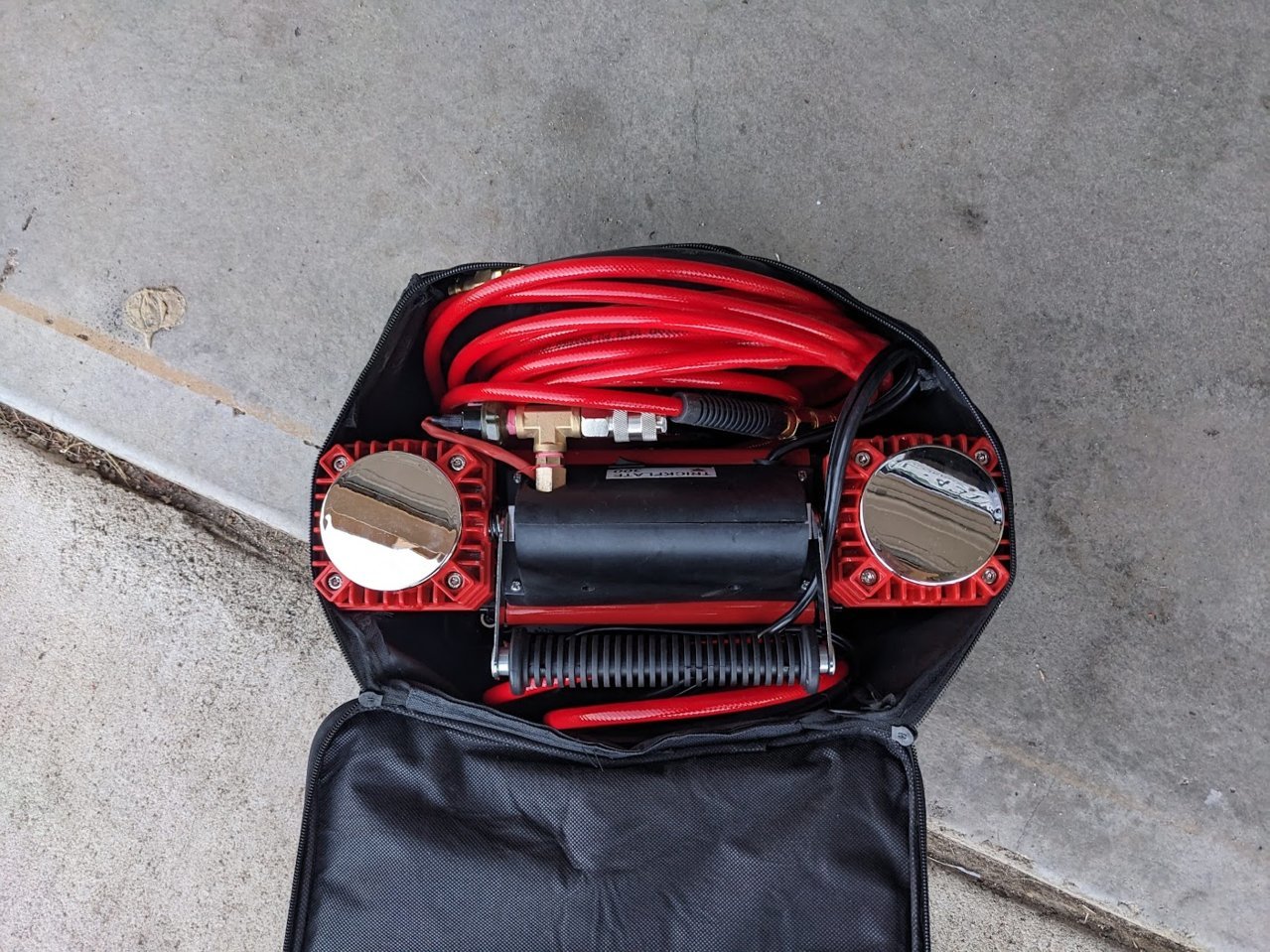

    Built one this weekend inspired by this thread.
    Compressor is modified to have a pressure shutoff switch to be safe with closed air chucks. Short lead line so I can stand up while filling/deflating.
    AJFCJaXVJuhs1EDLCft4JQtrafe3qytBXd4GS610_23a034756864dcf02bb6d1c7e32086b00ce80ae1.jpg

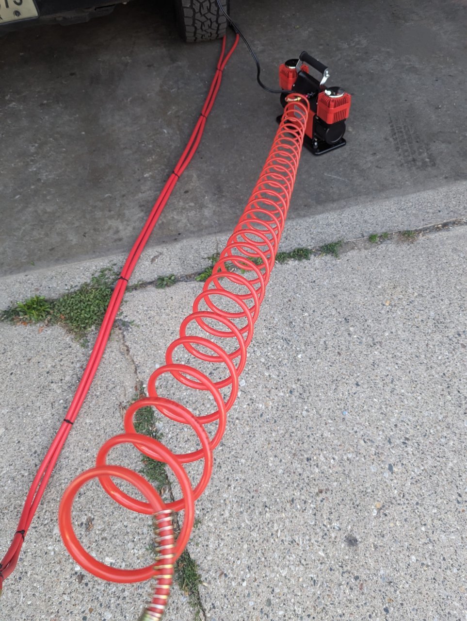

    Line is split to minimize hose to front tire for easier storage. Has just enough hose to get both rear tires if needed, but require moving the compressor around. I typically run F/R the same pressure, so this works well for me.
    AJFCJaWgBrL-kTo4vfMgVlifdtZTm1r33uumxzHW_3788ed33179eee3a304cc6d6564c9c04e09ce373.jpg
    Rolled up kit
    AJFCJaWRYAq412jNUSQmlZrhgSQcGtqKD9paGIVL_ca76c414e74d66ab6956b7d179716f707f88ea4b.jpg
    Stores in existing compressor bag
    AJFCJaWptX28DfP6MqeNpaKU2P99YeVlorU0kPVg_125aca32fcd3edcf6077a1eec36e8c5e1ea2be6c.jpg
    Some other thoughts:
    • There's a cheaper model of the clamptite tool. Works great, it's really a nifty tool. I used mechanics wire I had sitting around that originally cost a dollar.
    • Harbor freight is your friend for cheap NPT air hose fittings (and mechanics wire).
    • I did this for around $100, including the $30 tool. Have a bunch of air hose leftover.
    • I used 1/4" hose for storage reasons. Use hot water to soften the hose to aid getting it on the fittings. Take care to lay the fittings (especially the T) so things still coil nicely.

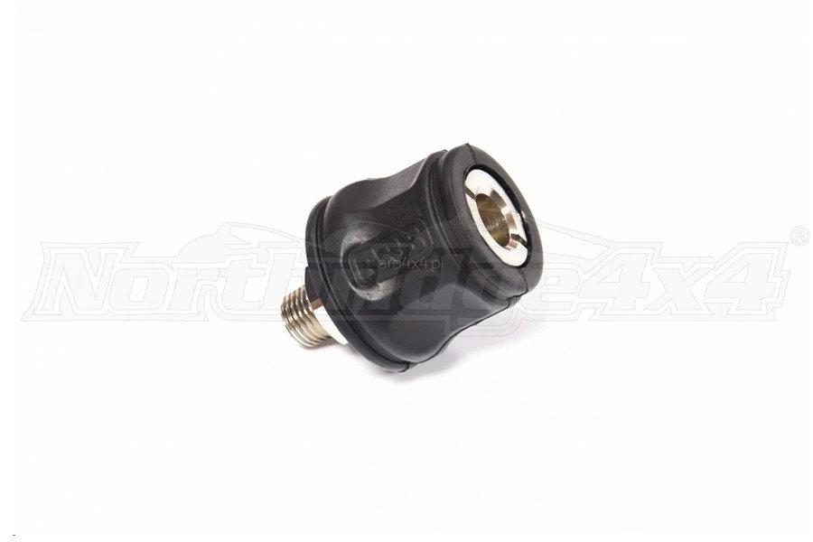

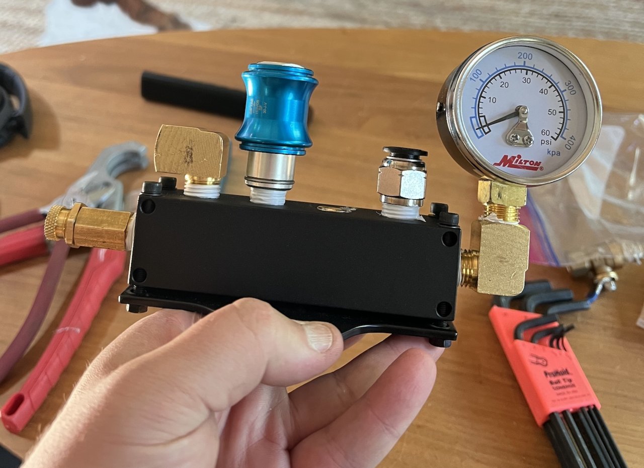

    I'm in process of building this out to use with an arb dual compressor I just picked up which will be mounted under the hood. Dumb question I think, but the compressor itself does not come with a coupling - is the arb specific coupling needed to attach directly to the compressor that an extension hose would then connect to from the inflator? I'm not sure if the arb coupling is universal to fit 1/4".

    It’s a standard 1/4”. You can get that coupling, any other one, run a hose with a remote coupling. Whatever you want.

    Perfect thanks remote I think is going to be the way to go. Switch in the cab, remote coupling somewhere up front, no need to even open the hood. That beer while others are fussing with airing up each tire is going to taste so sweet.

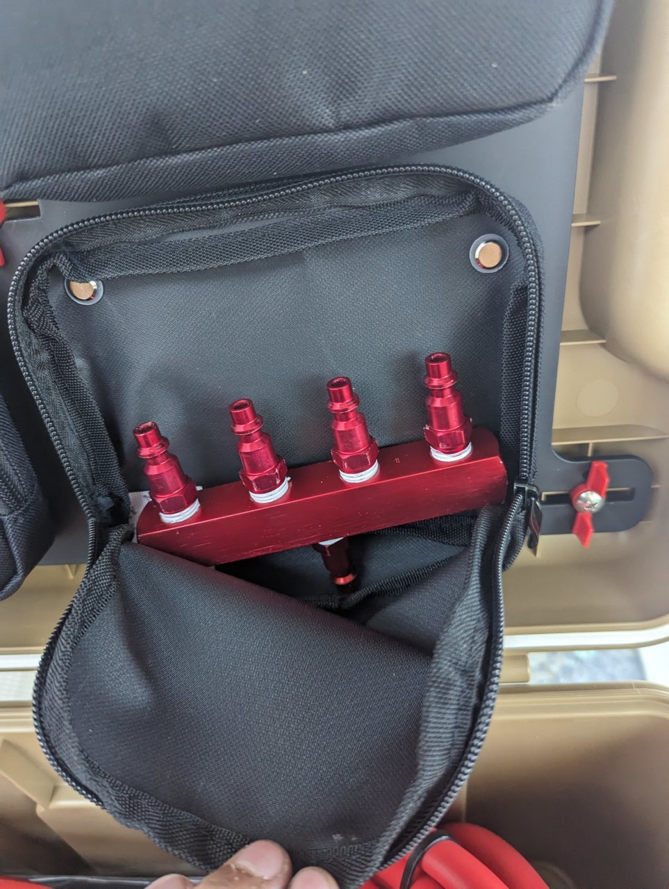

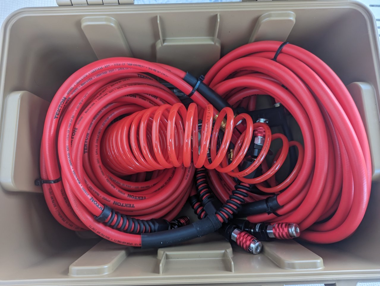

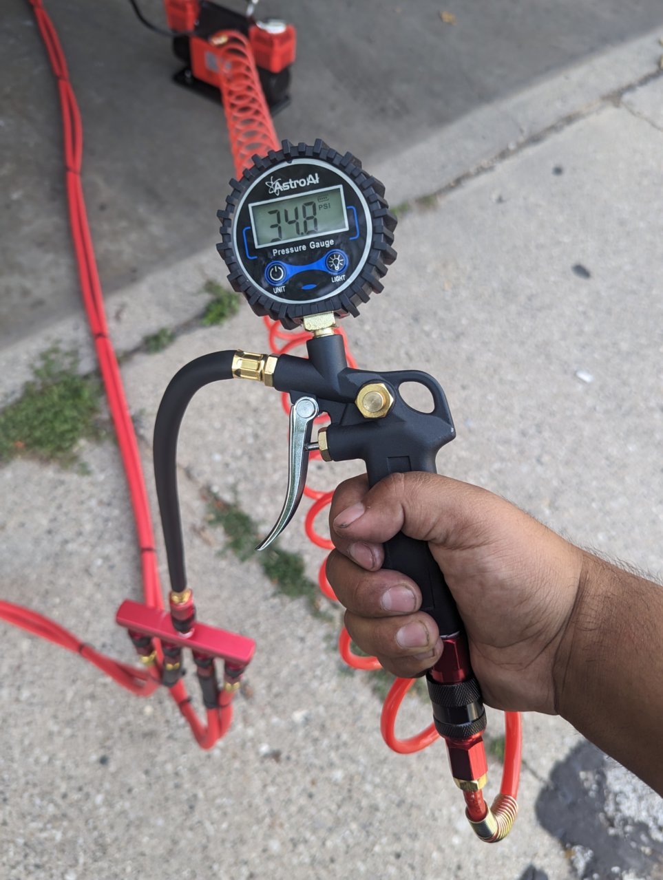

    Admittedly I started down this path to save money on a system like this. Technically I achieved that :anonymous:
    All in all the grand total came out to $398.62 (including taxes and shipping). Justified only by the $454.98 it would have been to just buy Morrflate's system (pre-tax and pre-shipping being added).
    Used it twice so far to play with some Apex valves I had installed and it's been working like a dream. The only improvements would be made to the compressor itself. That's a whole other rabbit hole that can wait until funds magically appear. I do have another 6ft hose from Tekton on the way to replace the 1/4" hose the Astro AI inflator tool comes with.
    It's all currently sitting in a Pelican knockoff I got from Costco. Parts post will be separate as I feel like I'm bombing the thread already with pictures :sorry:

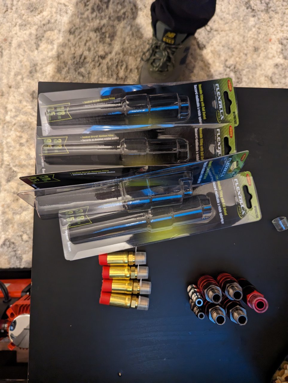

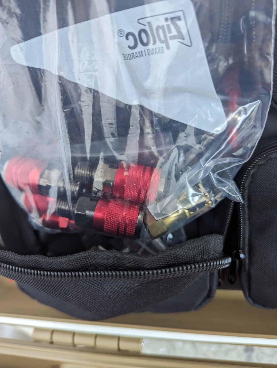

    Started off with hoses I bought on a whim from Tekton before I even ran across this wonderful rabbit hole. Fortunately/Unfortunately I got all of them on clearance since they're discontinuing all air hoses for the time being. Also had some rewards burning a hole in my pocket and that helped bring the cost down.
    This one is currently set to connect to the compressor. Apparently nylon has a high melting point. (I hope).
    https://www.tekton.com/25-ft-x-1-4-in-recoil-air-hose-4625
    Two of these for the front tires a la @Shellshock
    https://www.tekton.com/3-8-inch-id-x-10-foot-hybrid-lead-in-air-hose-46134
    Two of these for the back.
    https://www.tekton.com/3-8-inch-id-x-25-foot-hybrid-air-hose-46135
    Replacing Astro AI hose with this one.
    https://www.tekton.com/3-8-inch-id-x-6-foot-hybrid-lead-in-air-hose-46133
    Subbed Haltecs for these just for aesthetics. Stupid I know.
    Thor's Lightning Air Systems Dynamo Lock-On Air Chuck (Closed) (Set of 4 Chucks)
    This one had a lightning deal. If I had to do it again I'd get one with a manual glow in the dark gauge. And a different trigger design.
    Limited-time deal: AstroAI Digital Tire Pressure Gauge with Inflator, 250 PSI Air Chuck and Compressor Accessories Heavy Duty with Quick Connect Coupler, 0.1 Display Resolution, Car Accessories for SUV, Truck, RV
    These are the bee's knees.
    Flexzilla Pro Air Hose Reusable Fitting with Ball Swivel, 3/8 in. - RP900375BS
    Mostly only got this for the manifold itself. Ended up swapping out the couplers for male ones from the compressor seller.
    Hromee 4-Way Straight Air Manifold 5 Ports Aluminum Industrial Pneumatic Air Compressor Quick Connect Socket In Line Type Air Hose Splitter with 4 Couplers and 1/4" Male NPT Plug
    Speaking of the compressor seller....killer deal on basically the same base compressor Morrflate sells. No pressure switch is the cheapest option. You do have to order more than $40 or it won't let you check out. Probably freight pricing issue.
    https://www.tireflate.com/product-page/300lpm-12v-twin-cylinder-heavy-duty-air-compressor
    Female couplers to attach to Flexzilla Pro Ends.
    https://www.tireflate.com/product-page/4-universal-1-4-female-npt-quick-connect-air-couplers
    Male couplers to replace the ones that came with manifold.
    https://www.tireflate.com/product-page/1-4-inch-npt-male-industrial-air-hose-quick-connect-adapter
    Random coupler kit from Walmart to add more quick connects to the Astro AI body.
    Hyper Tough Red Aluminum Universal Air Coupler & Plug Set 5 Piece , 13-205RHT
    Pelican knock-off case from Costco. Didn't add to total cost since I already had it for ratchet straps and misc. stuff.
    https://www.costco.com/coho-pack-and-carry-box.product.4000101667.html
    I think that's it. Thank you to everyone for the great ideas and solid base to build on. This was a blast to plan and put together. Hoping it lasts long enough to justify the costs :facepalm:

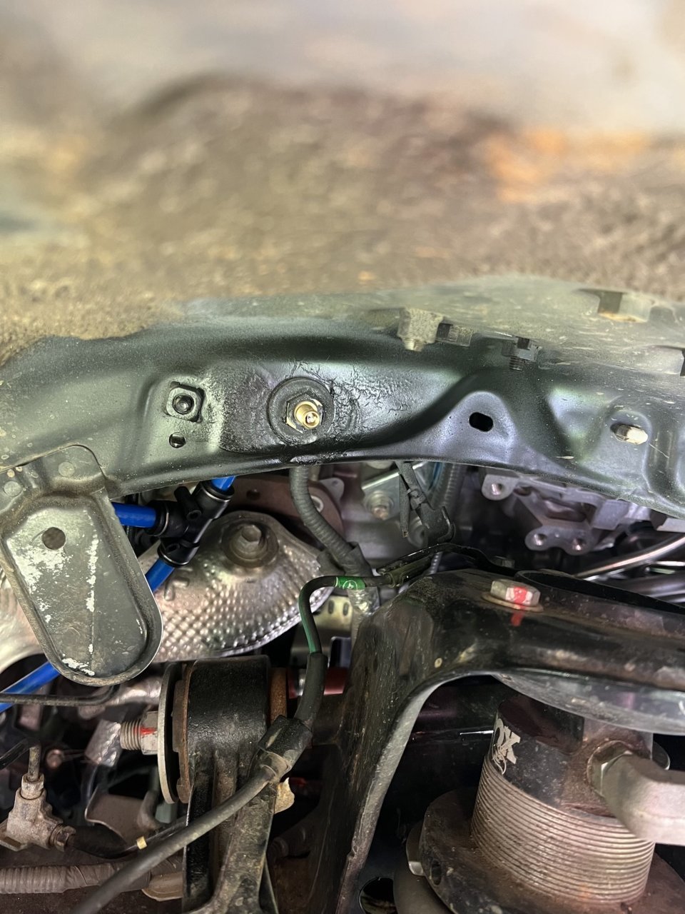

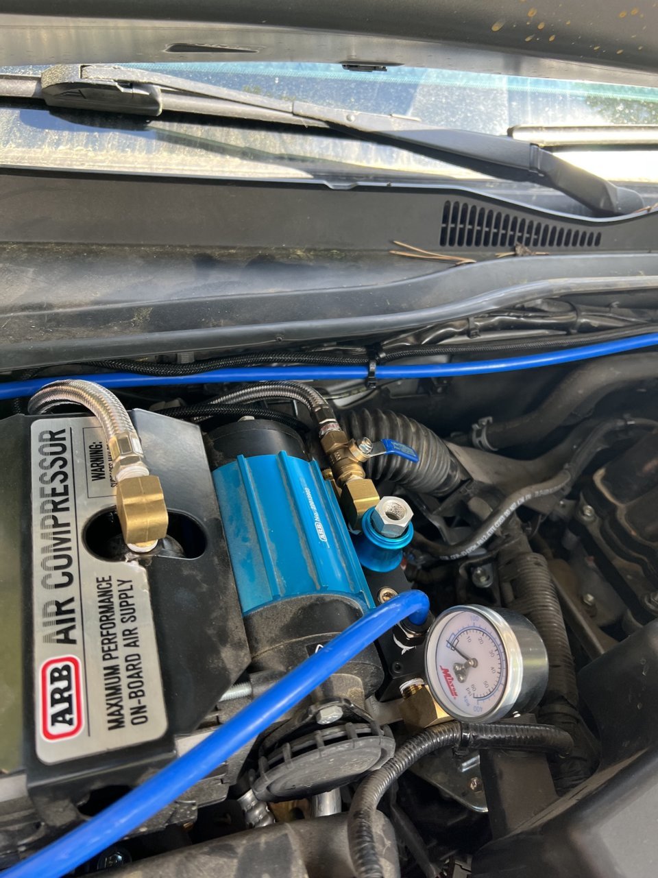

    I borrowed from this thread to do a straight-to-wheel permanent install that is similar to Rago's wifey kit just... cheaper and better. I can't imagine why anyone would buy that kit.
    I just grabbed the Viair 92820 from Amazon: https://www.amazon.com/gp/product/B00RMC4J2Y and the Haltech Schrader valves along with some generic fittings. The nice thing about the Viair 92820 is that it mounts to the mount intended for the ARB manifold on the Slee Offroad mount because it has a base plate. If you just omit the base plate but run the bolts down the side and throw a larger washer on the bottom, it fits in perfectly.
