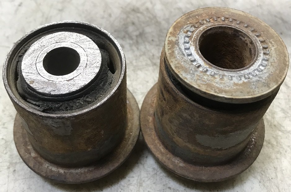

    Don't do anything now until you next need an alignment. You then have to cut through the bushing and bolt to remove the LCA and service it with new bushings or replace with new LCA, and you'll need new cam adjustment parts. I had to cut the hardware on my passenger side and replaced with Febest parts. Consider removing the cam bolt on the other side and grease the bolt; the bolts usually rust and seize inside the bushing sleeve. See link above on how to cut the bolt. Below are my cut bushings, after I removed them from the LCAs. One on the left has seized bolt in it; one on the right is driver side. Both are the front bushings.
