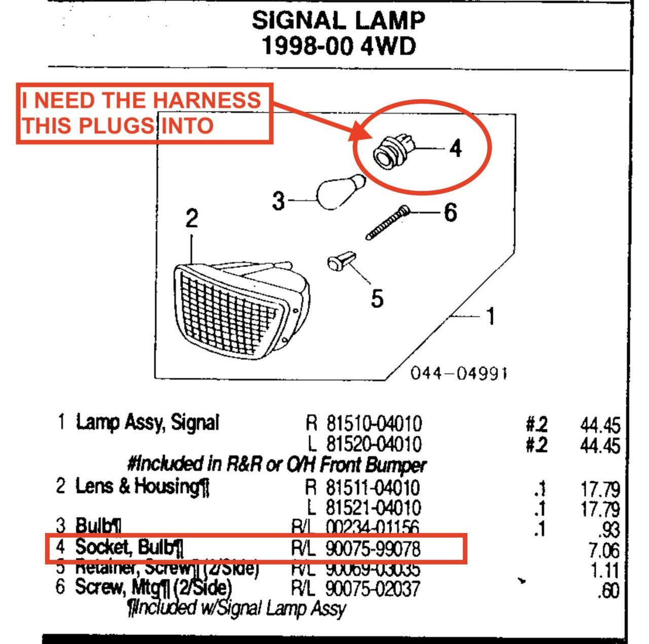

    I'm seeking a replacement harness part number for the turn signal lamp socket part 90075-99078
    2000 tacoma 4wd 3.4L 5VZFE.
    I have the new lamp, bulb, and socket. I do not have the harness to connect it to.

    Please see the attached image for reference.

    It is called a pig tail.Almost any parts store has them.
    Then you hard wire it to your harness .
    What happened to the one that was there?
    Simple to make your own with the correct size pins .

    No local parts stores here have them. I'm on Kauai, in Hawaii. We do have tons of auto parts shops here, but small inventories. They couldn't even find a part to order in their system.
    I think I found the correct part number: #
    90980-11019
    I've ordered this one from Amazon: https://www.amazon.com/dp/B0B3913LXW
    It also looks like Rock Auto has it too. https://www.toyodiy.com/parts/p_U_200004_TOYOTA_TACOMA_VZN170L-CRMDKAB_8202.12.html?hl=9098011019

    1999 Tacoma sr5 trd
    I ordered that pigtail from rock auto, but it was different than the factory pigtail coming from the truck to the bulb. The old one was 2 wire and the new one from rock auto was a 3 wire pigtail. Ended up not using the new one, did some farmer wiring to get my signal working again.
