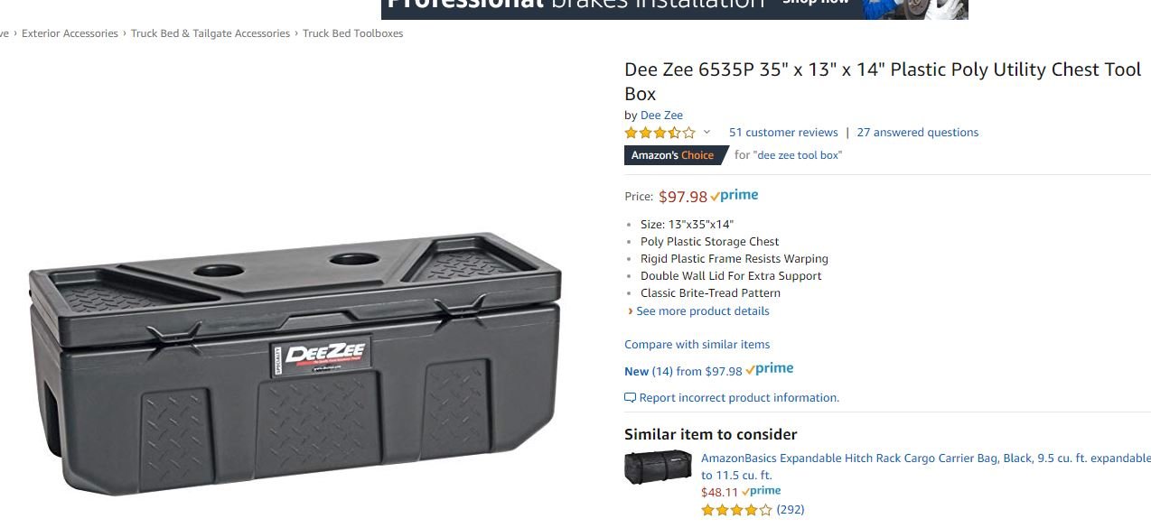

    Hey guys - I need a place to securely store portable compressor, recovery rope, detailing products etc. in the bed. So far the made for this purpose boxes are way more than I'm looking to pay. What I would like to do is purchase a well made poly box such as the one below and secure it in such a manner that someone can not easily walk off with it. Understanding of course a motivated bad guy will figure things out given the time.
    Ideas on securing the below box or any better ideas to achieve my goals will be appreciated.

    Do you have a cap? If so, do what I did - make or get a platform and get a box that fits out of sight under it
    for your stuff. I keep my compressor, tools and recovery gear under mine all the time, and my dark colored platform looks like the bottom of an empty bed when you look at it through the windows.
    if you don’t have a cap, you could always secure it down through the bottom of the box and bed or through its side or back into the bedside, and put a locking ring inside the box.
    Or get a heavy cable or weatherized chain and put an eye in the bedside.

    Is that box lockable? if not what keeps someone from just taking the items that are in it and leaving the box?
    If you get a lockable box just run a cable lock through one of the bed tie downs to the lock on the box.

    How permanently do you want it attached? You could drill a hole on the bottom of the box and bed and run bolts through both of them, making it a more permanent solution as stated above or if you want to remove it, do the cable through mounting point also suggested above. It all depends on what you want.

    If the box fits over the tie down, then you could modify it so the box locks into it from inside the box to hide and protect the lock.

    It's a plastic box. If they have the tools to cut a cable lock they have the ability to cut the box open much faster. I think the OPs main goal is to keep honest folks honest. If he needs it to be more secure he needs to go with a metal solution instead of plastic.

    Slide carriage bolts into the bed rail and drill holes to match. You'll still need a lower mount point such as one of the bed bolts to have 3 points of contact otherwise every bump will cause it to flex at the bed rail.

    No cap. It looks like mounting to the bed is the most common method for securing a box. I also like the idea of making two brackets that would mount to the box with inside locking ring and the other end running along the rails. This way it could be easily moved front to back along the rails as well as be removed. Surely someone has already made these brackets lol.

    Yeah I didn’t know you were set on the polybox, if you got a metal one it would certainly be stronger, but then you will be opening up a new issue. Like USMC mentioned above, the thief will cut the easiest part to take something. If you have a strong box attached to the bed, the thief might be tempted just to cut the plastic bed around the box and lift the entire thing out with a piece of bed attached to it. It’s sort of like when you put on a secure locking gas cap, I did that thinking I’d thwart gas thieves until they tried to drill out the cap lock but couldn’t do it, so they just drilled a hole in my gas tank instead.

    Isn't there drain holes on the left and right in the front of the bed? A piece of 2"X2" angle aluminum to span the 2 holes. Bolt through the holes. You can now bolt the box to this brace.
