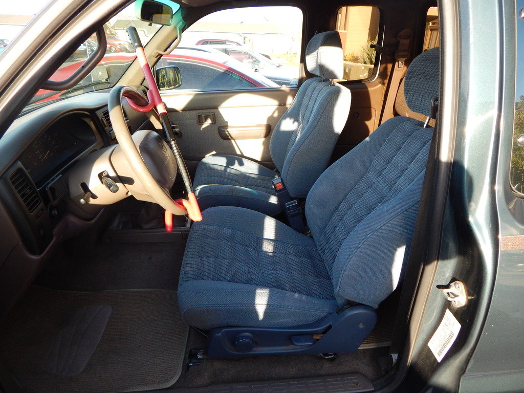

    So the SR5 buckets in the pre Tacoma trucks will bolt right into the Tacoma floor pan with no modifications?
  13. Mar 29, 2018 at 11:15 AM

    No, they will not. I had pre taco seats and I had to weld my taco mounts to them.

    Pretty damn far and they mount their seatbelts differently so you have to get creative there too. The back legs don't line up and the fronts don't either. I wouldn't just try to bolt one in.
