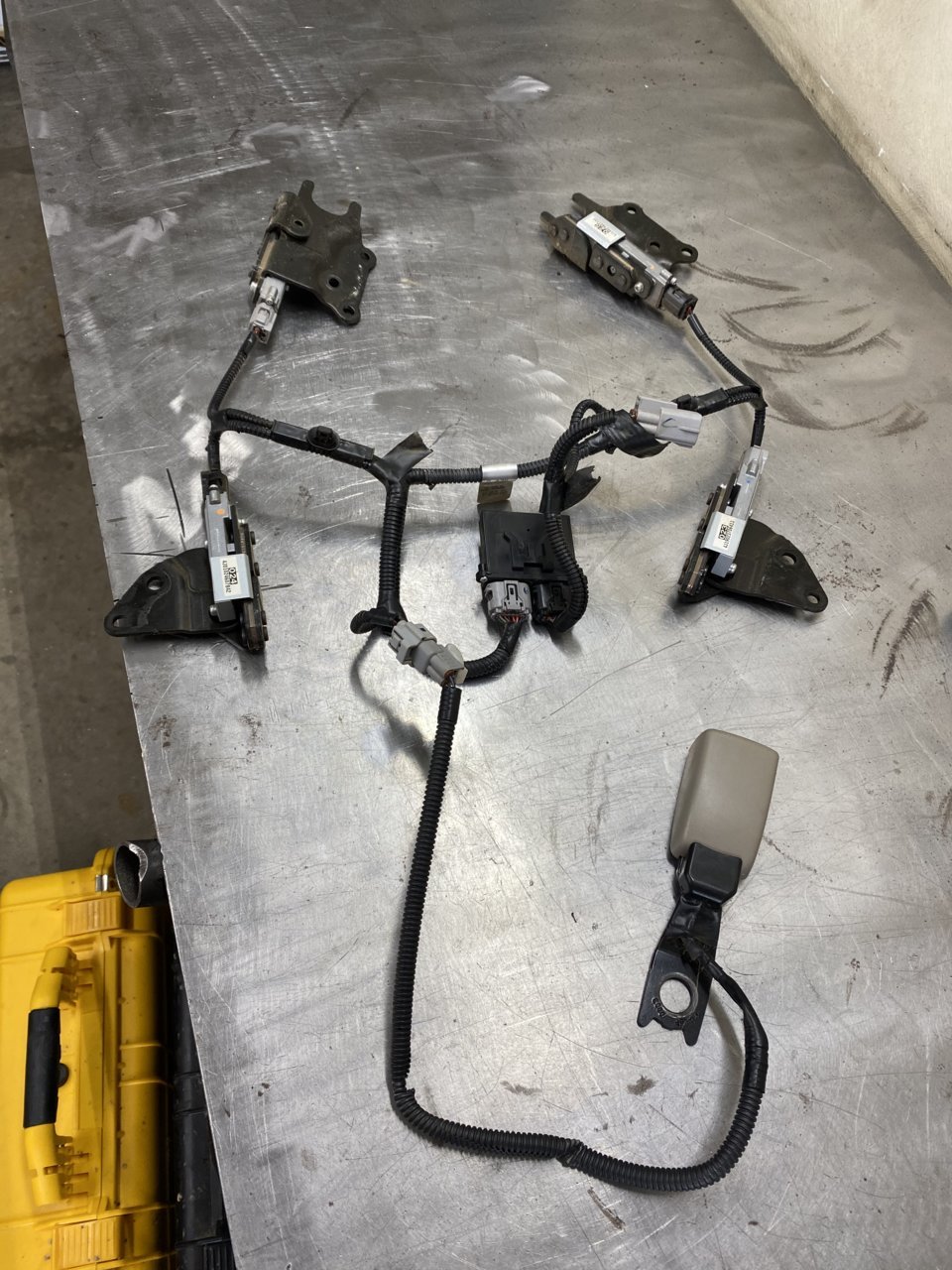

    Ah, that's a good point. They don't have airbags but they do have airbag sensors. The drivers seat has a position sensor which tells the computer how close the seat is to the steering wheel. The passenger side has an occupancy sensor, which is a whole clusterfuck of sensors in there to see if someone is sitting there or not.
    This was from the passenger seat on my 2005. I hose clamped them to simulate someone sitting there and then secured them under my passenger seat.

    I swapped in Audi S5 seats. you can setup the pressure sensors as @EatSleepTacos noted the airbags inside I have not seen anyone tackle. It may be possible. It haven’t gone down that road yet.
