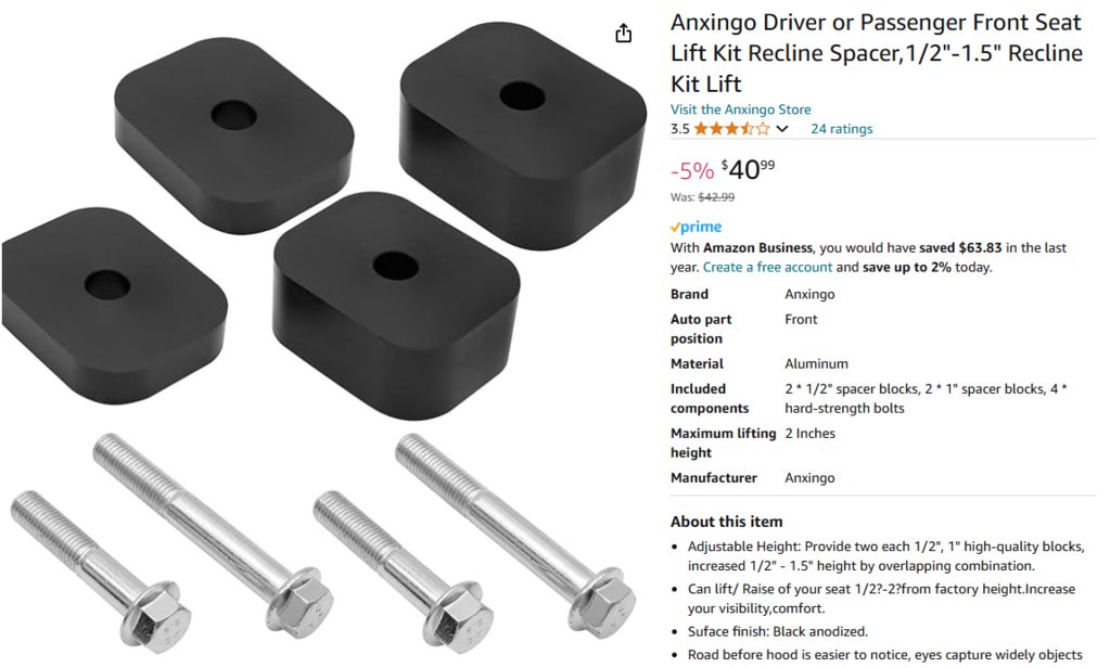

    I picked up 2 of these kit on Amazon (driver and passenger).
    I tried only the thicker block first about 1", it was an improvement. I then tried with both the thin and thick for the full 1.5" and it was better. Wife and I are both very pleased. She's 4' 12", so she appreciates the extra height too.
    PUMPKINKING likes this.

    PERFECT!! Thanks for sharing! I was planning to cobble up a MacGyver (Mickey Mouse?) fix for this, but I like the kit with the aluminum blocks...

    Back to the hombrew solution, I pulled a bolt and they are definitely 10M, but not sure of the pitch. Anyone know if these are 1.25 or 1.5?? They look like fine threads, but I need to educate myself on metric threads...
    I plan to run out and get some longer bolts. I guess I can bring this one and match it up.

    Not sure this is helpful but the bolts holding the rear seat are 1.25. I would imagine the fronts would be the same.

    I bet you are correct. I was surprised that none of the seat jacker products I looked at listed the actual bolt sizes! :mad:
    Also, I see 8.8 on many of the metric bolts in my hardware bins, and I assume that is hardness. Should I be looking for a certain grade of bolt? Or is the nut ripping out of the sheet metal the more likely failure point? I guess the seat belts will keep me in place in the event of the worst-case scenario. :) Oh, and I am sure the online kits use the cheapest hardware possible...

    I would wait for someone more knowledgeable than me to reply but I believe the bolts have markings on the head to signify what grade of bolt it is. I would replace it with the same bolt grade that is currently holding the seat in. I agree that the online kits probably use the cheapest crap bolts than can find and would not use whatever they provide.

    Thanks for the replies. And I am definitely over thinking. I am not attached to the seat in any way, so there should not be a requirement for upgraded hardware. The seats are not going anywhere in a crash, and it is the belts, not the seat that hold the driver in place.
    Looks like I should be able to knock this out with a purchase of 4 bolts and scrap material in the shop for the spacers. For a grand total of about $20. I am only lifting the backs of the seat, so I might as well do the passenger seat too.
    I see that the previous generations needed a lift at the front of the seat, so I think Toyota may have overcompensated in the new design. I would not think that the power seas would have this issue. And probably not even an issue for many - just a personal preference thing for me...

    The seat retains your body's relative position to the belts.
    I wouldn't want my seat going anywhere in a rollover.
    Personally, I think it crazy to mess with this hardware that has gone through regimented crash testing. But I am very risk averse.

    I agree, but in a rollover, the seat is not holding you in position; the belt is. But I am risk averse too and like to do things right.
    If the factory bolts were marked, I could replace like for like with regard to the grade/hardness. I will be putting in a longer bolt to accommodate spacers, and I probably need to do some more research on hardness grades of metric bolts. I am guessing that 8.8 is around the equivalent of grade 5. I might search Grainger or a specialty hardware place for the higher-grade bolts - once I decide on the height of the spacers.
