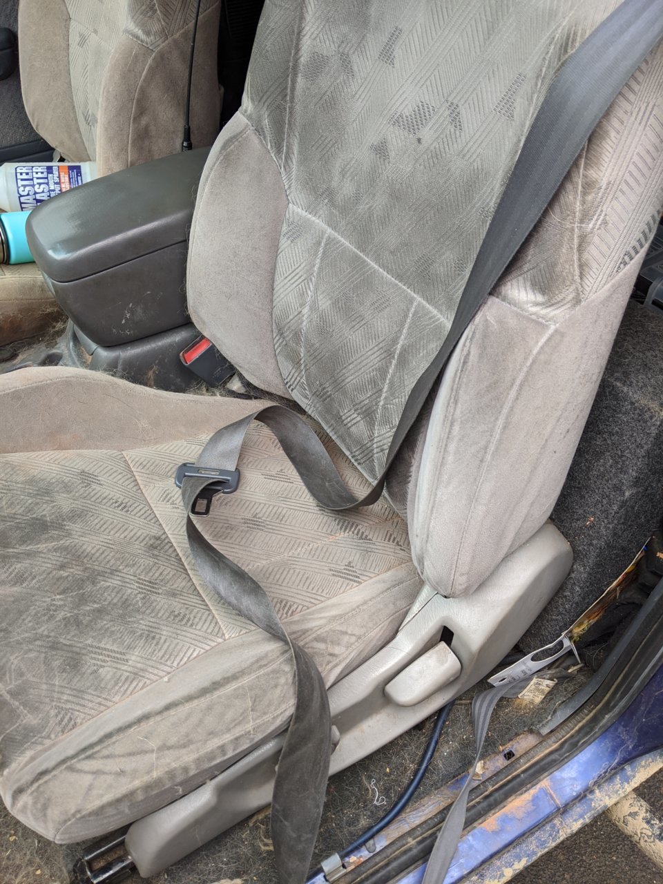

    I wish Toyota knew how to make seat belts? Mine wore out on retraction,,,, so I bought two new ones from Toyota,,, still won't retract most of the time,,, sometimes yes, but barely.
    Anybody pursued taking them apart to make the "whatever" spring wind tighter? I think it's doable but just don't want to make it not do it's job when needed, never hopefully. They're limp

    Did you get the whole retraction mechanism and the belt, or just the retraction assembly? A dirty grungy belt is not nearly as flexible and anything will have trouble retracting it.
    There are several threads of people taking the assembly apart and cleaning everything (including the belt), lubing it and it ends up like new, or better than new. Just do a search (here and/or google), you should find them.

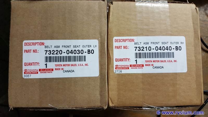

    All I know brand new seat belts are smooth running and very efficient on retraction. I had them like that when I bought my truck in 1998, my 2012 4Runner still runs tight, and now new replacement seat belts for Tacoma. Just to be clear what I'm talking each came in the box like that:
    On the picture you can see how much belt is left when they are fully retracted:
