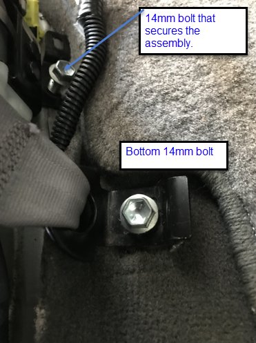

    Hey guys. I'm so tired of people riding with me and the seat belt not retracting. You know the feeling...someone in the office will ask for a ride, and when they get out the damn seat belt is hanging there like a limp d....

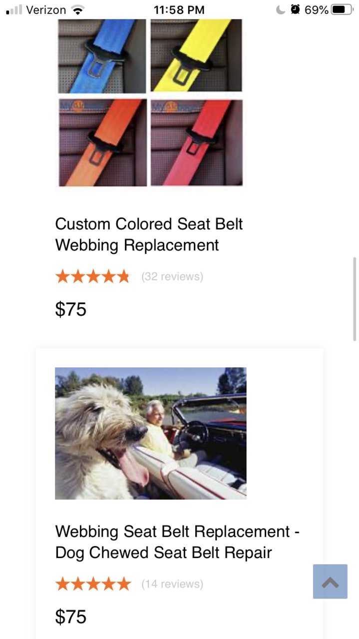

    So, this weekend I removed the passenger and drivers seat belts to be shipped tomorrow to myairbags.com.
    This will be for the pretensioner repair. Total bill for the repair of two is $179, which includes them shipping it back by FedEx.
    I wanted to post the whole procedure from start to finish for those of you who are on the line about replacing or getting them repaired.
    Below are some pictures of the passenger side seat belt being removed.
    Stay tuned...more to come
    https://www.myairbags.com/product-category/repair-return/seat-belt-repair/
    Quick Notes from my experience (I have a Double Cab)
    • Remove the front and back door sills. This will help in removing the cover or panel to access the seat belt.
    • To remove the cover (paneling)....gently pry the sides out and then LIFT UP to remove. If you just try to pull it off you'll break the plastic tabs on the cover. Ask me how I know.
    • All bolts that secure the seat belts are 14mm. Total of 4
    • Disconnected the Negative battery cable (was worried about disconnecting the yellow airbag connections). Not sure if you have to do this or not, but I didn't want to take a chance.
