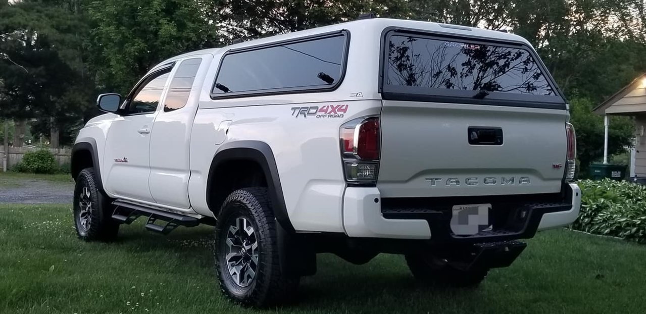

    Only aesthetic mods so far Leer 180 cap & Clazzio covers on order.
    I think you'd be hard-pressed to exclude absolutely ALL moisture & dust.
    My '06 TRD OR had 2 rear cubbies. Both filled with dust and got damp at times. My '21 only has one and its interior gets dusty. That dust does migrate into the bed.
    Water (albeit minor amounts) WILL get into the space enclosed by your trucks bed and its new cap. Troublesome spots IMO are the 2 front inside bed corners and the cap's rear door. Leer's weather-stripping along the top of the door works, except for each end where it stops. Always find a small puddle after a rain when the truck is facing downslope, not so much when it's headed upslope. Haven't crawled up to the front corners to see if the cap dealer's fix for water intrusion at the front corners actually proved successful.

    I have a Leer 180. It would not be effective in my case, as the water is coming in at the top corner of the door not the sides.
