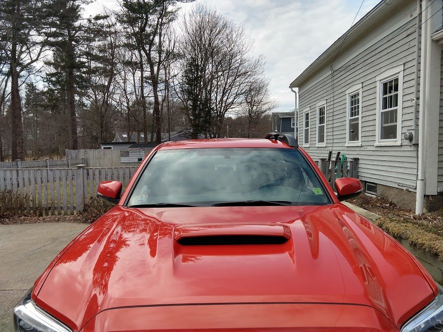

    well...I lexel-ed them...and....did not pay attention to the weather today....installed the rack yesterday and it rained today....filled up the rain barrel but no leakage! Guess I got them sealed up good.

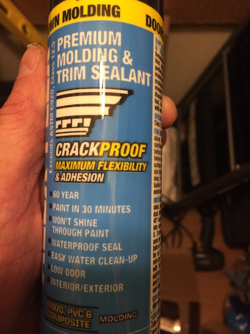

    I used many tubes of this sealant along with other types of caulking and silicone on a recent whole house interior remodel.
    It’s entertaining that they just keep raising the number of years this stuff will supposedly last.
    20, 25, 35, 40, 50 and now 60 years!
    I’d be curious to see if it really lasts anywhere close to that, but I’ll be long dead before the year 2079.
    100 year sealant, coming soon!
