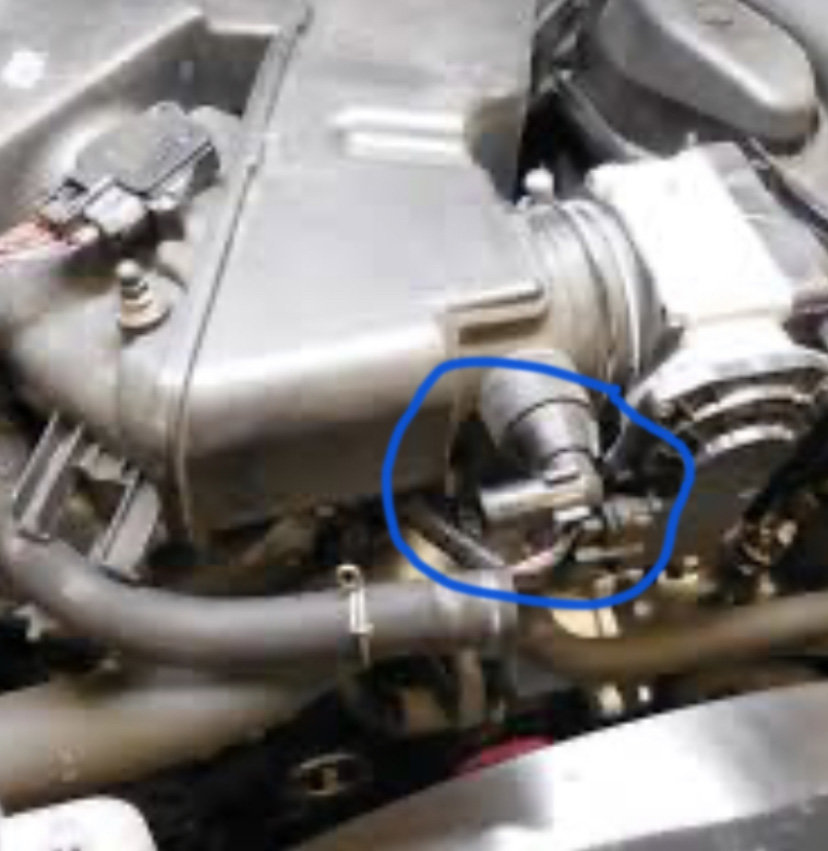

    I have the Seafoam spray (not the one that's poured)...can I injected it into this port (see attached photo) as it would be easier than getting that whole air intake system off just to get the straw attached by the throttle body? Thanks!

    I don’t think I would want to do that. That means all the crud the sea foam cleans and dislodge would get sucked into you engine. The idea is to remove the crud.

    Its pretty easy to take off the throttle body and clean. You tube has plenty of videos. While your at it change your plugs and pvc valve. If your unsure bring it to a shop.

    If you feel like the fuel system is dirty and needs cleaning get some fuel system cleaner Techron or Seafoam and add it to the gasoline as per directions.
    If the throttle body is dirty take the hour of time and clean it properly. What you are suggesting is half ass and will not accomplish anything.

    Yes you can

    Ahhhh.....another quick fix from "Maintenance in a Can"
    Best at depleting the thickness of your wallet, not so good at the cleaning task, pretty good at providing the "I took care of my ride" feeling.
    Cleaning the throttle body is an easy task. A few simple fasteners to remove the intake plenum, 4 bolts and a couple of hoses, the throttle body is off the engine (on the 4.0L V-6). Take it to the bench, a bit of spray carb cleaner, a few wipes with a shop towel.......clean as new. Reinstall. Might take 10-15 minutes from start to finish.

    No better than dumping it into the gastank or using Techron...
    Plus adding it to the gas tank doesn't have a risk of washing out the cylinder walls and/or hydrlocking the engine.
