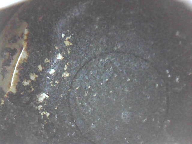

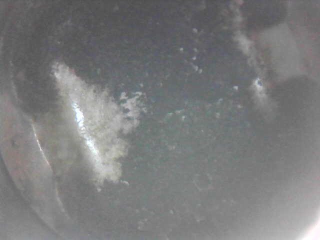

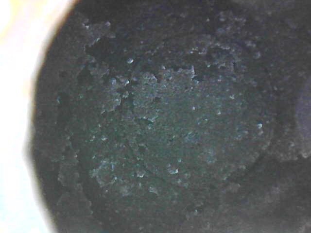

    So I was also thinking of doing something similar.
    I got a bore scope last year and have been sticking that sob everywhere I can.
    I’m at 175k on my 08 2.7 and was shocked to see how much carbon build up I had on my piston crowns.
    Guess I figured Mobil gas from the same very busy station with new tanks and pumps had the cleaners needed.
    Nope so I ran a can of SeaFoam in the tank and no change at all.
    Followed that with 2 bottles of Techron.
    Still looked the same.
    After some looking for proof online all of which was kinda hit or miss.
    I ended up getting some BG44K.
    Next 3 pics.
    1 before the BG and some time after SeaFoam and Techron.
    2 after 1st can of BG.
    3rd after 2nd can of BG ran back to back. They say it treats 20 gallons but I did it with like 15 or 3/4 tank. Took about 3 weeks depending on how much you need to get gas.
    I really didn’t want to blast a bunch of crap off to float around in the engine or ruin new A/F-02 sensors or screw up the cat.
    B43FB6F9-0758-4533-9EDB-6C679BF1EA0E.jpg 53D4C514-96D2-4FE0-AE60-35E17A282A23.jpg 31323851-ABA0-4605-B51D-06A65E7CD2C2.jpg
    I gotta say I was impressed with the results.
    Not a salesman for BG or a hater of the others nor am I a snake oil salesmen but I have ordered more and will continue to use this.
    My OBD reader shows better fuel trims and way better cat temps.
    Sorry for the long post and not trying to say use this.
    But this is my actual results!
    I wish I could get the scope up thru the intake manifold to see the valves.
    I also did the the BG induction cleaning after seeing what it did.
    Intake was dirty kept getting bore scope dirty and pics were crap.
    It’s absolutely spotless from what I can see now.
