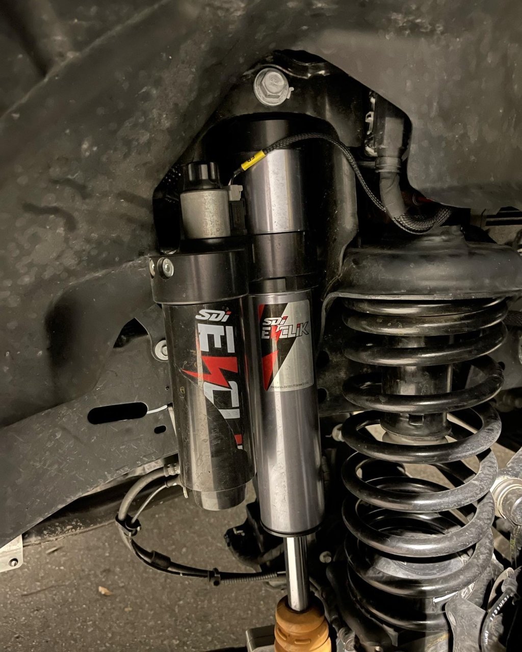

    I installed the front shocks last night so no pics of them in the box.

    I sucked it up and stayed up late installing this over the last couple days. Most of that time was running the wiring, still not 100% done with that as I need to move some existing accessory wiring and relays around to tuck it away.
    Still playing with the adjustments but I like it so far, feels like I have the roll bar back in the truck. You can definitely feel a difference when you make adjustments or drive in different modes.
    One thing I didnt think about is that my 05 is a pretty simple truck, I dont think it has a steering angle sensor or the correct brake sensor so the adjustments for that are useless in the SDI system and will probably just run off the IMU. I can not tell a difference when making adjustments to those two settings. Would be nice if the interface had a way to show what the sensors are reading.
    Initial feelings on it is that its a great all around suspension. Lets you do 80% of what a purpose built suspension does, for example soaking up hard hits like a digressive valve shock but still be soft at lower speeds but it doesnt quite do it as well as if it was purpose built for one or the other. I did not expect this to outshine something made for a specific task, I wanted flexibility which this does. The truck handles much better and feels more planted around town but is not quite as harsh as my icons were. Real test will be how it does out in the field.
    After I play with this more I will do a more complete write up.
