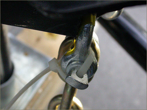

    For the screw type, just zip-tie the hole on the screw tab to the shackle once it's installed. The screw won't be able to rotate relative to the shackle, and if you're not equipped to cut off a zip tie in the field, you probably shouldn't be out anywhere you might need to remove the shackle.

    There's an accepted way to properly secure a bow shackle, which is how it's done for rigging and ships and what-not.
    But a zip tie works just fine for making sure they don't rattle off your bumper.
    Personally, I would only use Crosby (red), Gunnebo (yellow or brown pin), Columbus McKinnon (CM, usually orange), Campbell (blue) or Van Beest (green pins). You'll often see knock-offs painted to look like the real ones but I'd only trust the genuine ones from trusted sources.
