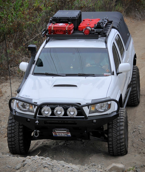

    Im assuming you want them flat like the rotopax? or is this okay?
    Edit: never mind, you want it completely flat, misunderstood when you were saying "on its side"-->someone did it on a roofrack on a fj

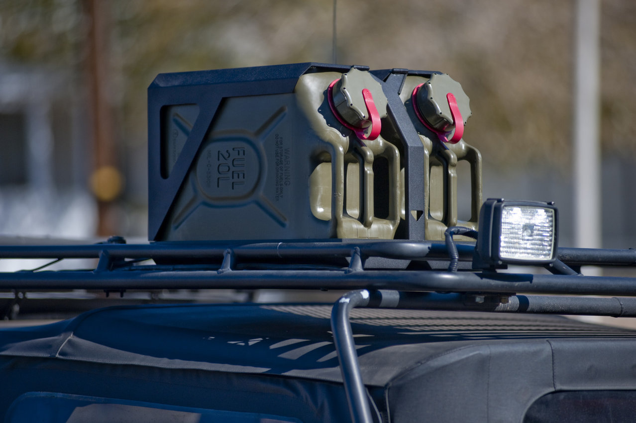

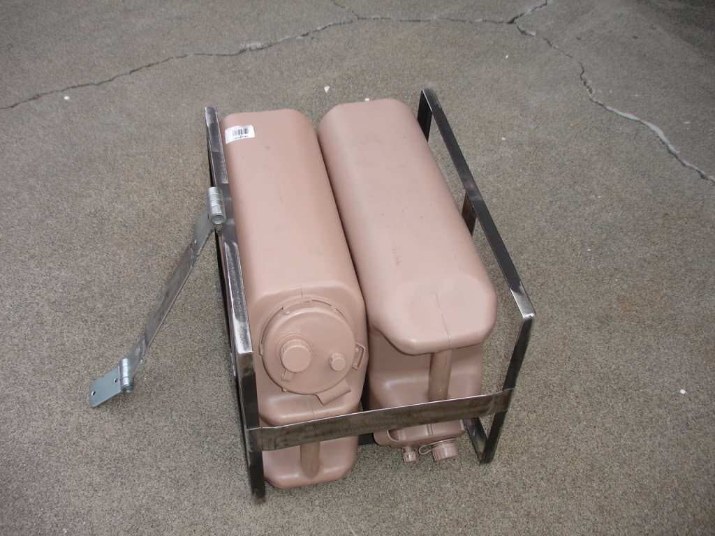

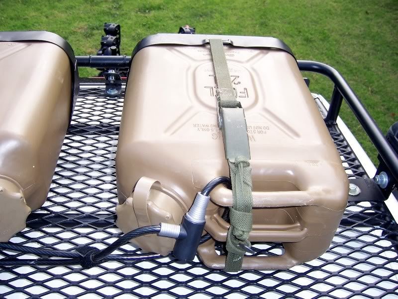

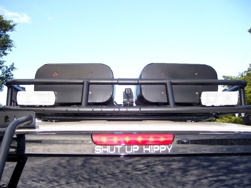

    There are a few solutions out there:
