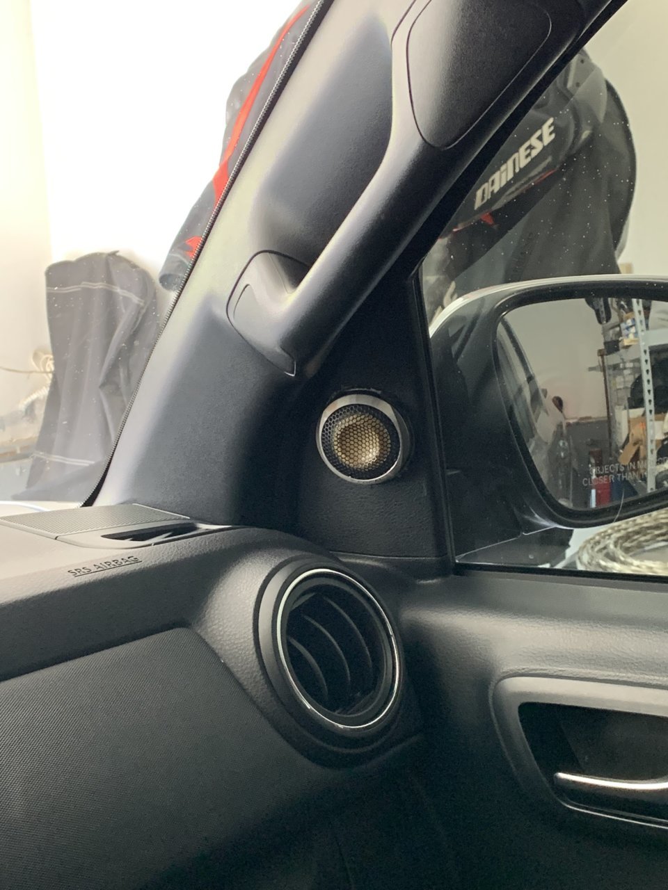

    For reference, here is the a-pillars. Anyone interested in them, I would be open to offers. They would include tweeters and mids and K2 woofers.

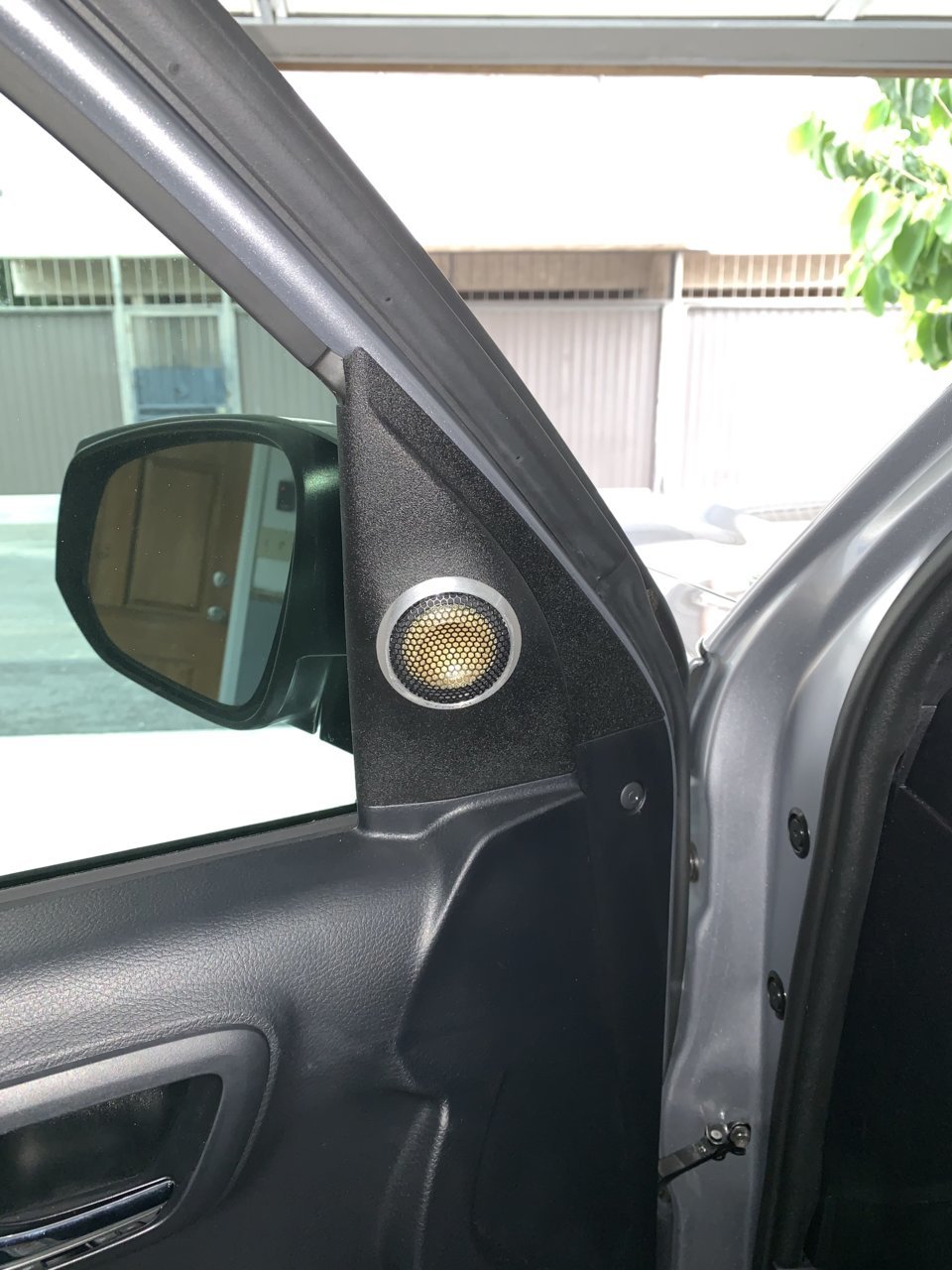

    7B939366-B139-460D-AEDD-211CF9B441D8.jpg 17ECAC4C-191B-4A87-8BE7-ABE86E0E06A2.jpg 263A9DB0-63A0-4BC6-A3D5-8F12902DAB90.jpg DC114631-68E9-4C61-B775-737B7F06978F.jpg
    After much sanding and lots of body filler, I have finally finished these little pains in the ass.
    I am happy with the final result.

    Like the texture . Bedlinner ?
  8. Jul 23, 2019 at 12:56 PM
    lardawge
    lardawge [OP] Well-Known Member
    Jul 23, 2018
    #260361
    106
    2018 TRDS DCSB 4x4 Silver Premium
    SEM texture coating.
