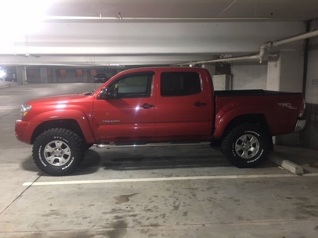

    I recently installed a 3 inch front 2 inch rear lift on my 2011 because the truck seemed very low to the ground. Now after after the lift which netted me 4 inches front and 2 back. I'm sitting at just above stock. Will the factory suspension sag this much in 100k miles?
    Current center of hub to bottom of fender numbers..... Front 22 rear 23.5
    I want to go taller with a DB lift and am thinking about 6 inch to make up for the sag. Netting roughly 4 inches all said and done. Running 285-75r16

    Yes it’s possible your leafsprings have gone flat an at 100k if your still running stock front shocks might be a good idea to get them replaced.

    It sounds like you installed spacers on your stock suspension, not a lift - if that is the case, yes, it will settle, especially with high miles. While it shouldn't take you back to stock, I would always recommend doing a true lift as opposed to a spacer lift.

    The truck will see 95% pavement, I don't need a $3k setup. I've built and wheeled many jeeps in the past and high dollar suspension isn't needed here in GA for my type of wheeling.
    The spacer lift if only 700 miles old.

    I'm in no way recommending a "high dollar lift" but rather a budget, true lift, as opposed to spacers. The spacers will only further stress and fatigue an already worn out suspension. I would expect it to hold up longer than 700 miles, but the tape measure says other wise.

    Also, with 4" of lift in the front, I hope you got new UCAs...

    Just a heads up, the leaf springs were a TSB not a recall. AKA you'd have to pay for it out of pocket if you want those done. In that case I would either buy an AAL or maybe look at Ride Rite bags for the rear. Bilstein 5100's are a good option for shocks. Fronts are ride height adjustable so you can level out that rake.

    Replace the leaf pack, front nt coils, and shocks and ditch the spacers. You are also going to need UCAs to get a proper alignment.
    (I know it's been said but it seems like you didn't see the posts or didn't really come here open to recommendations to fix your ill advised budget lift)
