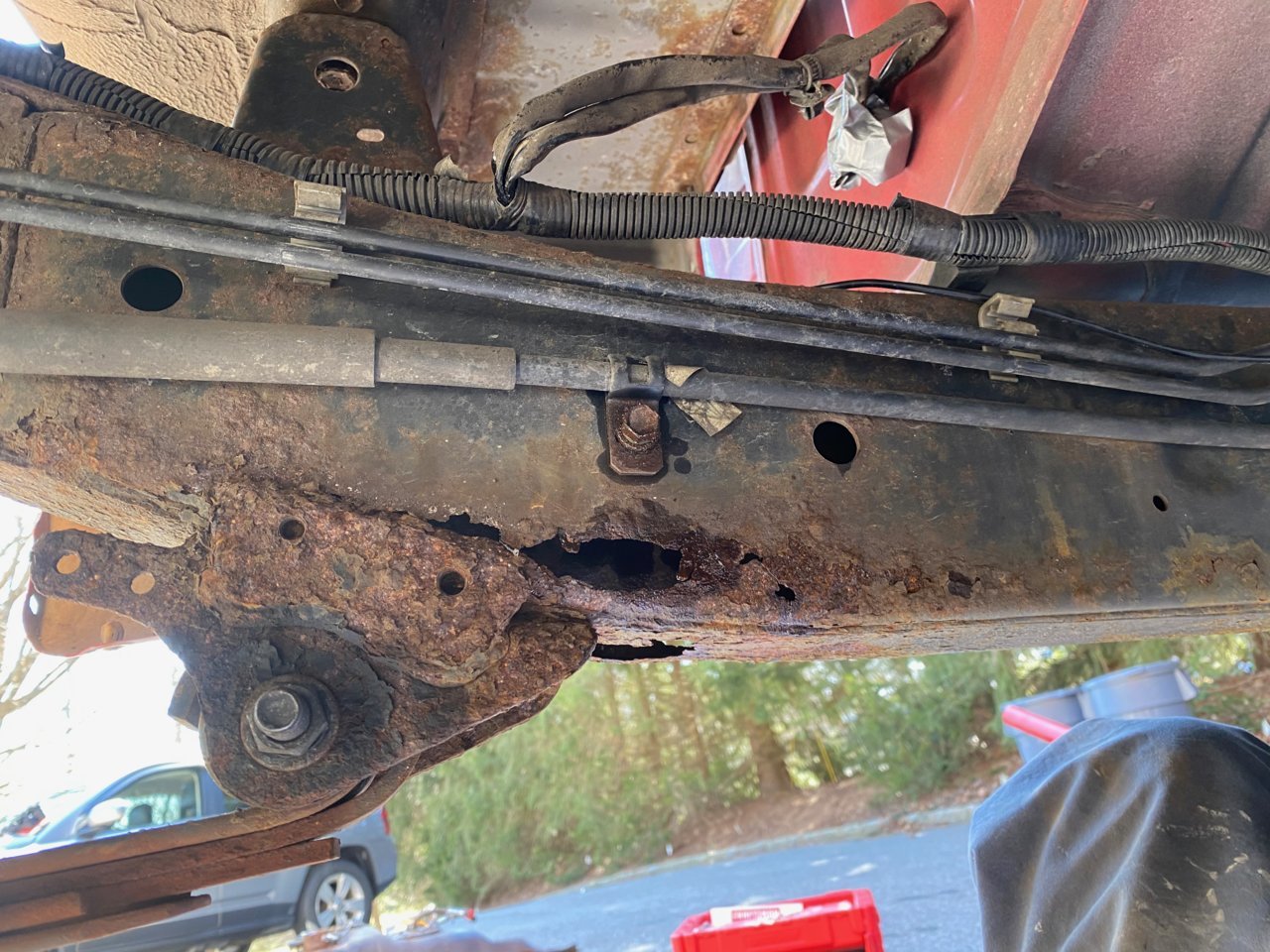

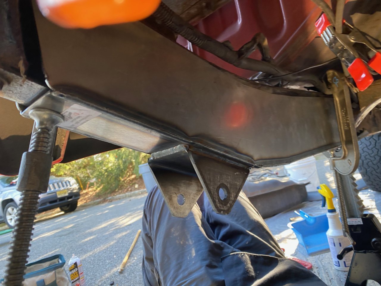

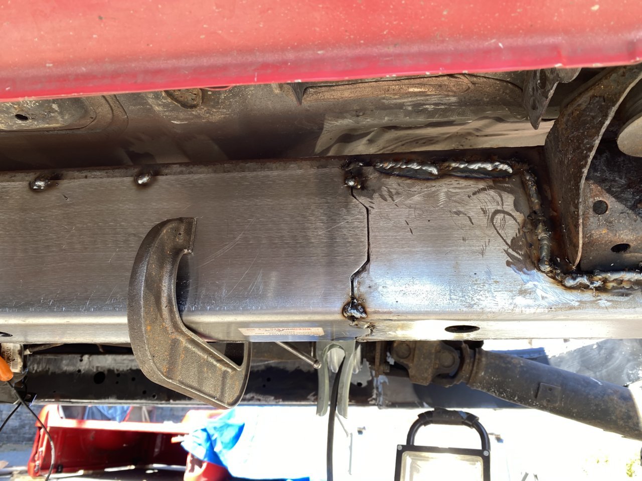

    im in the middle of an install of the safetcap mid frame section,
    i got the driver side tack welded on yesterday, i should get the passenger side on today.
    I'm doing the install the way the instructions say, with the bed on so as not to warp frame, what a pita.
    I'm planning on removing the bed after all is welded on in order to treat/coat the top of the frame.
    i found more rust than i thought in the center frame, so I'm thinking I'm going to go ahead and do the center safetcap section too.
    does anyone have any suggested additional repairs while I'm here?

    Maybe make some new Spring Hangers .
    Hard to tell till they are cleaned up .

    If you mean the leaf spring hangars the safe t caps have shiny brand new ones.

    I’d cut out as much rust as possible. Keep in mind, you can’t weld to rust but I’m sure you know that already. You could also drill holes in the replacement part and plug weld for a bit of added strength along each side provided there’s something to weld to. I’d also treat the inside of the frame before welding and then after with a cosmoline or Eastwood product.

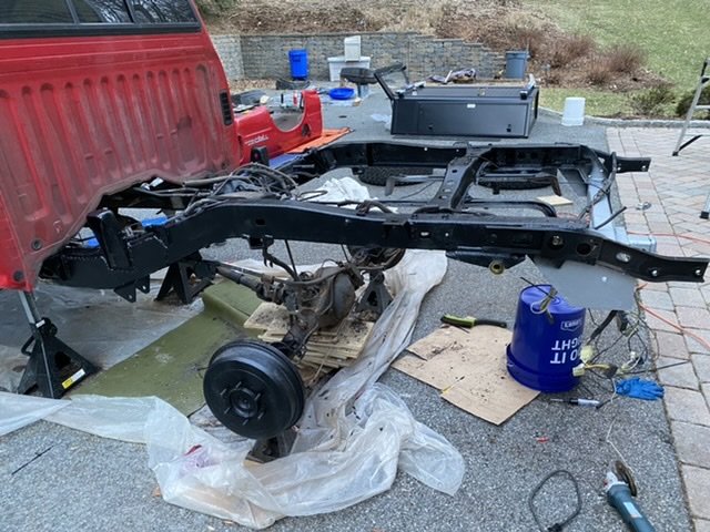

    I cut 1" off the top of my mid section caps and beveled to 45° which allowed welding overhead without bed removal. I highly recommend Corroseal and a 360° wand extension on undercoating gun to spray inside box frame AFTER all welding is complete. Good work saving another 1st gen.:thumbsup:

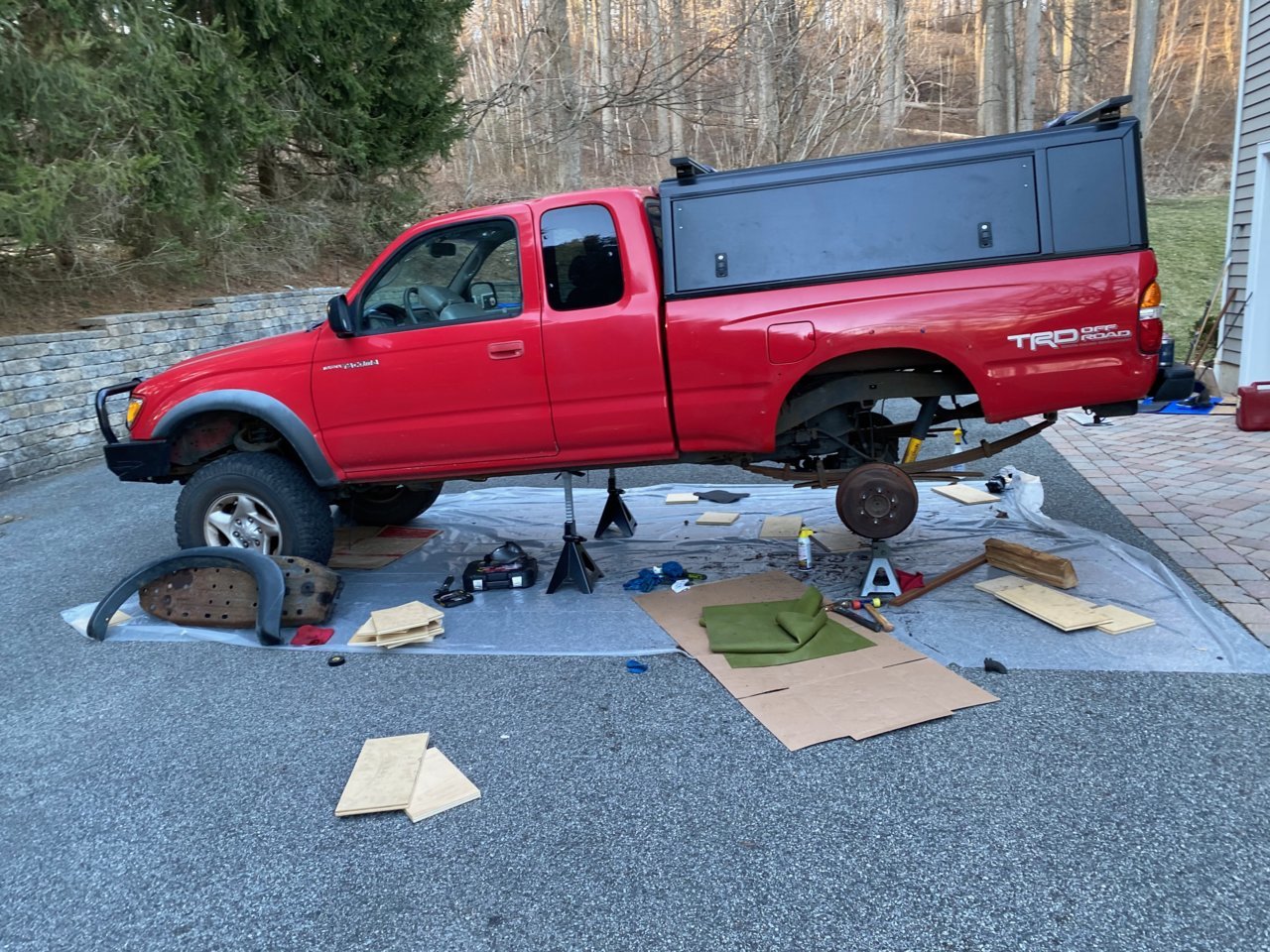

    I’ve got the Eastwood interior frame spray, The platinum chassis paint, the black rust encapsulater, and the chasis satin black, phew...
    It’s going on one week, thank good for my in-laws kindness, driveway, and them being in Florida while I do this project-
    I’ve got the rear section of the frame coated with the Eastwood platnum, and top coated with the extreme chasis black paint-
    The safe-t-cap is welded in a place,
    And the topper and bed are removed.
    big bummer is two of the six bed bolts are seized, so I’ve been messing with those, and my buddies miller multimatic 200 mig gun trigger burned out, it’s not a stocked item anywhere so I can’t do any welding on the center section of the safe-t-cap until hopefully Tuesday at the earliest.
    here’s the pics...

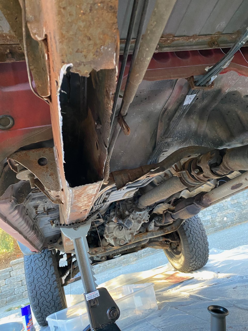

    Here’s some updates, after the mid section safetcaps installed. I had time while waiting for parts to degrease the front part of the frame in order to look for more corrosion (I did find a little bit, nothing I need to do now)
    Mid section went in well.
