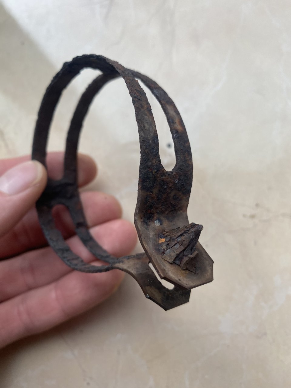

    B61AA24C-47D5-4395-B150-517BD0F40987.jpg 2013 4.0 Tacoma ..Hey as I’m sure a lot of people have posted about exhaust rattles thought it was the heat shield but ended up being what looks like a loose exhaust clamp it’s not a Main clamp with two bolts and can’t seem to find any info on it .It was completely rusted loose and just hanging over the exhaust just below the drivers side seat near the catalytic converter not sure if it was originally there or rattled down the exhaust over time . Anyone know where it was originally and if it’s important to replace Asap Thankyou !! Including picture of the part

    Ya I know which two your referring to those are like a flange , this mystery clamp in picture has the slots in the middle and very different I’ve searched through the threads can’t seem to find any info , thanks for the reply

    That clamp goes on the AFT end of the cat shield. The clamp is P/N 9008046121 and bolt is P/N 91511B0614. Same thing happened to me a few years ago where I developed the rattle noise and noticed that my clamp had rusted through leaving the clamp just dangling around.
    Recent thread for your reference: https://www.tacomaworld.com/threads/cat-heat-shield.742707/

    Thankyou that’s it ! Is it okay to drive without it for a few days?

    There’s been more than one guy DIY that problem.
    These, the whole pack, are cheaper than 1 clamp from Toyota. Even a regular stainless screw clamp should work.

    Ya I was thinking about using those or heavy duty stainless hose clamp the stock clamp isn’t very different , just wanted to make sure it wasn’t gonna be a issue driving without it for a couple days . Thanks for the replies!

    Considering that some guys don’t even have the shield period.
    I’m thinking a “couple days” probably isn’t going to be detrimental
    See post 13 & 14 here. These guys are still active on the forum.
    As far as I know they are still going just fine with out them?
    @Empty_Lord @12TRDTacoma

    No heat-shield isn’t a horrible thing but can expedite rust on the frame potentially due to the heat.

    I don't have a shield on mine, been that way for a really long time. No issues here. The same exact thing happened to mine except on mine the bolt 1000% seized and there was no removing it so I just trashed the shield.
