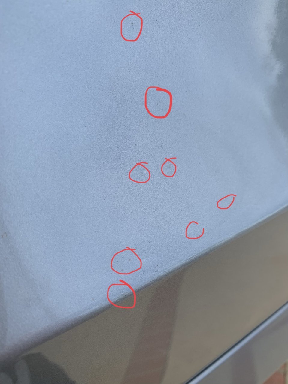

    Hey guys,
    Washed my 2018 Silver Sky Mettallic today and noticed these spots all over both front fenders and some areas on the hood. Tough to see, but will show itself in a shaded environment. Made me panic a bit. Did some research and appears it could be rail dust? It’s a pain to rub out, having to apply a good amount of elbow grease :annoyed: sorry for the crappy pic, it’s a tough show out in lighted areas. There’s probably close to a good hundred on each side.
    Bought the truck last July. I don’t live that close to the beach; approximately 6-7 miles away. I usually wash my car about 2-3 times a month and use more higher end cleaner products coupled with microfiber clothes, so I do believe I rather take good care of my truck. The only thing I can think of that could have done this was when I had taken her in to get a CMC done several weeks prior; possibly caused by some of the metal cutting/sparks? :confused:
    Just reaching out to TW to see what y’all think. I’m hoping I can find a permanent resolve for this.

    Clay Bar it

    You need to clay it and then use an iron remover. A mother's or Meguiars clay kit can be purchased at any auto supply shop or big box store. You saturate the paint surface with detail spray, then just knead and then slide the clay over the surface. Knead it again and then move to another spot. The trick is to use a LOT of lubrication (detail spray).
    You don't "rub" or scrub. You simply slide the clay across the surface and it will remove the bonded contaminants.
    Then you need to spray it with an iron remover. Lots to choose from. McKees, IronX, several brands available on Amazon. You spray on (no direct sunlight as you don't want it to dry), let it sit, and it will change color as it dissolves the remaining iron (rust).
    Pretty simple process. Get some clay, detail spray, and the iron remover. $50 and you'll be set.
    Then do a final wash after the iron remover does it's thing.

    Thanks for the advice! How long do I allow the iron remover to sit for?

    Oh, maybe 5 minutes. Then spray it again to make sure you got it all. As I said, it will turn color in presence of iron. If it doesn't turn color, it's all been removed. Here's the whole process.
    Wash
    Dry
    Clay
    IronX
    Wash
    Dry
