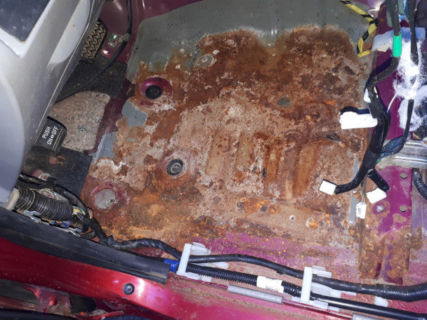

    Due to a few leaks in my truck, which I was unaware of, I have quite a patch of rust on drivers side. It looks like I caught it before it had a chance to get really bad... relatively anyway.
    I have a few questions before proceeding:
    - What is that top layer that separated from the floor, seen in the second photo (my mystery material), and what should I replace it with? it looked to me like a second metallic layer on top of the floor but I do not know what it is and it came off in pieces on the drivers side.
    - was it structural at all or just insulation against noise?
    - is por-15 rust preventative a good option for this location or would Rust-Oleum’s rust reformer be better?
    - other better options for treating this area?

    I have had this issue but not as severe as in the red Tacoma on the photo there.
    Im surprised you didn't smell a dank musky wet floor liner. In any case.
    • Are you referring to the material highlighted in yellow? my best guess is its a heat absorbing membrane or some kind.
    • No, you can peel it off with a plastic spoon, it will reveal the steel body layer highlighted in orange.
    • You can use either or, the objective is the same. To stop rust from spreading or re-building.
    • Its up to you, I would remove all the rust, add some kind of tac weld sheet steel and spray paint it white. OR Just remove the rust and spray paint it white. (Why white you ask? its easier to find water, oil, or other crap than black.)
      nothing more annoying than punching a hole thru your cars floor.

    The stuff outlined in yellow is a heat/noise dampening material. Search YouTube on how to remove it with dry ice or have lots of painful fun scraping it off. Remediate your rust with wire brush, rust reformer, and then paint over the cleaned up metal, and then just put on your butyl sound treatment layer as a replacement for the OE stuff.

    the material is likely sound deadening people remove in race cars to reduce weight. I don’t know if it has other insulating properties such as heat and if that’s important. There’s probably replacements available out there, if not run of the mill dynamat type stuff. That may even better.
    whatever comes factory was probably chosen for cheapness and ease of install being mass produced at a factory.

    So here is what I ended up doing for the rust. Before and after shot of the worst spot included. (my fixes for the windshield and back wall pressure vent are also in through the links above)
    - Disconnected battery.
    - Pulled wire harness guides and harness out and worked around them as best possible.
    - Took drill with wire brush and nylon abrasive brush to all areas with rust or spots of rust.
    - Rinsed all areas with water.
    - Scrubbed all areas with CLR and let sit for 30 min.
    - Scrubbed all areas being treated and entire floor area with degreaser.
    - Rinsed thoroughly and dried all accessible areas as best possible.
    - Put heater and fan in truck overnight to fully dry.
    - Took soaked with acetone and thoroughly wiped all areas being treated.
    - Sprayed several coats of Rust Reformer over exposed metal / rusty spots.
    - Let dry.
    My carpet was pressure washed, scrubbed with degreaser / cleaner, pressure rinsed, had excess water removed with wet / dry vacuum, then draped over sawhorse and air dried... sooo clean now.
    I still have to remove rust from seats then repaint but I have started putting all the stuff back in.
