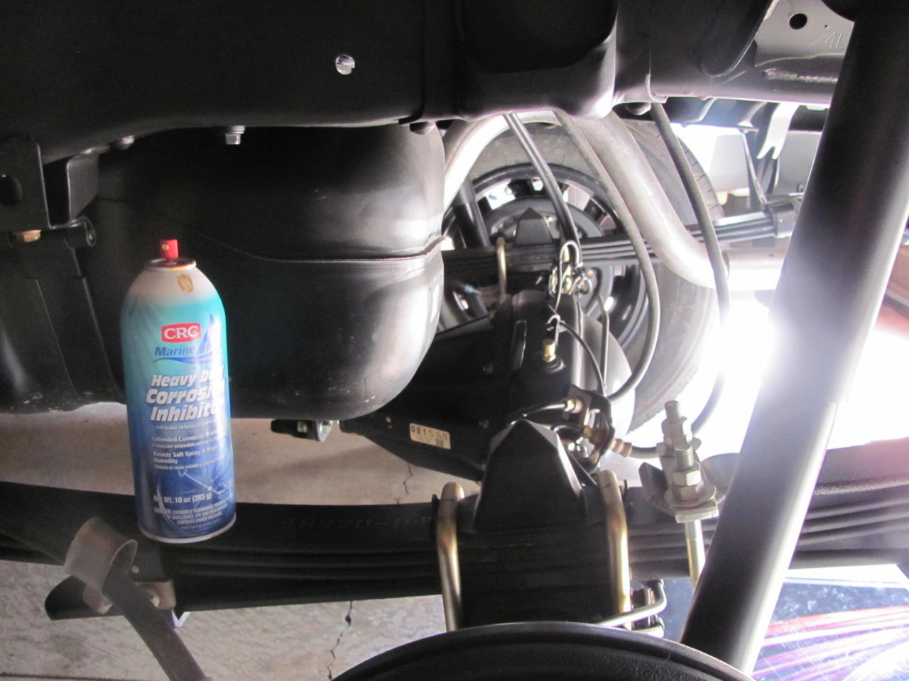

    I used this for undercoat on my new SR-5, I have done fluid film but it never dries and comes off over the winter....I liked this stuff.
