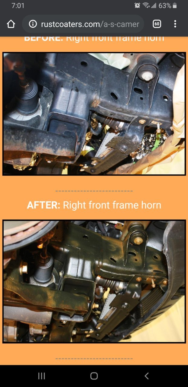

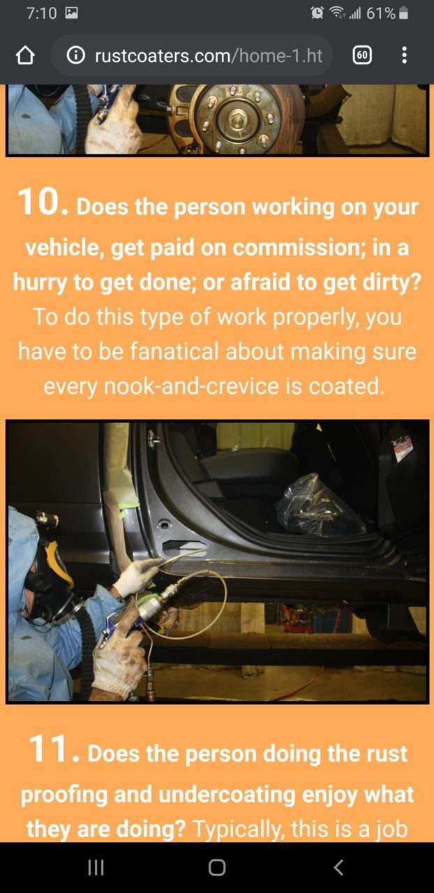

    Planning on doing a lot of rust proofing to my taco next summer. If doing it myself I plan on using fluid film on the entire frame or possibly attempt painting the frame with POR15 if I have the space to do it.
    Otherwise I found another option for a shop out in Wisconsin that appear to be experts in rust proofing they have lots of details and how meticulous their work is on the website... http://www.rustcoaters.com/a-s-cameron.html
    Only thing I want to know is if anyone has experienced in using the product they use cosmoline I'm assuming they use this version of it... https://www.cosmolinedirect.com/cosmoline-rp-342-heavy-spray-military-grade-rust-preventive/
    Has anyone used or know anything about cosmoline? Has anyone on TW possibly even used them that live in the northern Midwest area?

    Thanks guys I think I'm going to pay these guys to rust proof the truck this summer they do so much with that stuff it amazed me! I want something much more permanent and dry to the touch. I have no plans on getting rid of this truck no other trucks appeal to me or make me happier to have than this truck!

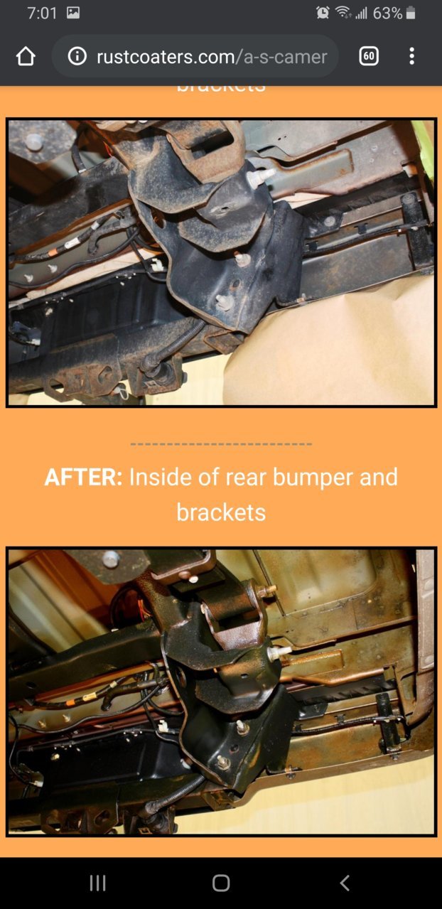

    That's very interesting thanks for the heads up on that still worth it for the protection. What product does rust check use? Is it a wet heavy oil or hard resin?
  18. Jan 7, 2020 at 5:04 AM
    #18
    Monroe94
    Monroe94 [OP] Heavy Diesel Tech
    Jul 2, 2019
    #298052
    121
    Minnesota
    2016 TRD OR DCSB MGM
    Here's a couple of before and after pics of the cosmoline. I may still even use fluid film on certain salt prone areas even for extra overkill Screenshot_20200107-070103_Chrome.jpg Screenshot_20200107-070131_Chrome.jpg
