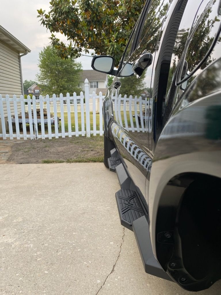

    Bought these HDX steps for $530 soon after I brought my Sport home in May 2021.
    It's over your budget but something to consider.
