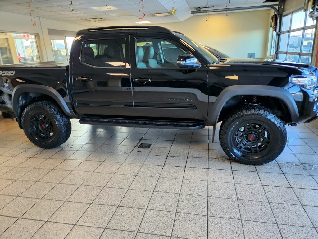

    275/70/17, factory lift , trd rims, General ATX tires.
    saev likes this.

    I have that same setup and wheels. Currently running 265/70/17. Any rubbing at all? How far off is the speedo?

    Absolutely no rubbing. I haven't had a way to check speedo. Doesn't ride or as quiet as my Murano but neither is my Vette. It's not noticeably noisy and rides like a lifted medium size pickup.
