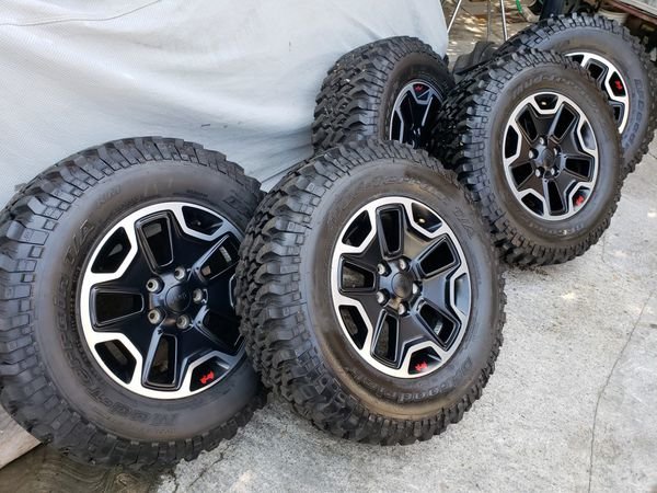

    Humor me here..... So I got a set of Rubicon Hardrock wheels I was going to use for my wife’s Grand Cherokee Trailhawk for winter tire swaps. Plans changed and we’re not going to use them.
    Here are the same wheels in discussion( no tires yet).upload_2019-9-21_0-58-36.jpg

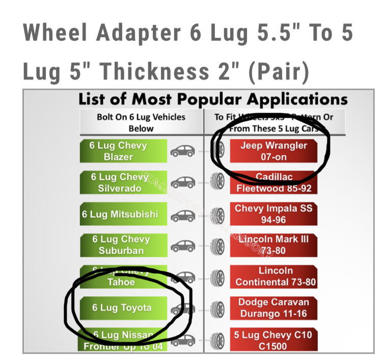

    So I did some research and found these also.
    I would obviously need to do a little more research on the spacers to find out about the hub bore but in theory they should bolt up.
    Now for the offset....
    TRD OR wheel are +25mm.
    The Jeep wheels are +45mm.
    The spacer at 2” would be about -50mm.
    That would give me a final offset of -5mm.
    So correct me here if I’m wrong but that should be the same as running about a 1.25” spacer on a stock wheel?
    So now let’s here your opinions on the matter.
