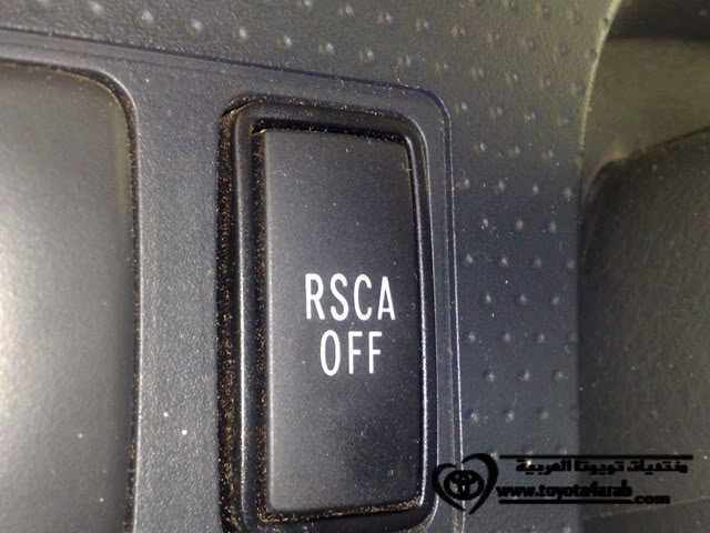

    Probably a stupid question (no stupid question, just stupid people asking them!), but how do you turn off side curtain airbags...I've never seen that switch

    Its a button on your dash to the left of the steering wheel. If you dont have a trd off road you might not have it. Not sure about the sports.

    So I got the base model 4x4, I didn't see the point in paying extra for tires, wheels, suspension, and painted bumpers since I planned on changing all those out anyway. So they recommend turning off side curtain airbags if going off-road, but only put that switch on the TRD?

    I'm pretty sure all models equipped with RSCA have it because regardless of your trim package Toyota doesn't want to get sued if the airbags go off unexpectedly.

    You have to hold the button in for 3 seconds and then a light should come on in your dash.
    The manual also states that the "RSCA" button allows the Seat Belts to be easily unbuckled while the vehicle is stopped on a extreme angle.

    image.jpg. So that is what that buttons for!
