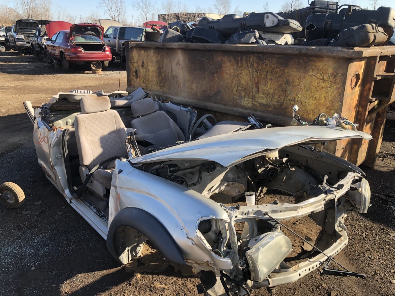

    After seven month of dead leads, scouring u-pull yards between Michigan, Illinois, Ohio and Indiana, searching FB marketplace ebay and craigslist, multiple ignored messages and calling full service yards. I finally managed to get a rs3200 wiring harness for my 2001 Double Cab. Earlier today while searching at a u-pull I ran across a bent frame and bed of an 03' Tacoma, and what remained of the cab a few rows over. It was absolutely trashed so I couldn't salvage the rs3200 module, glass break sensor and blinking light part but I did remove the 297140-42800700 wiring harness unscathed! (fun fact if you ever want to see a corner of the internet try googling "297140-42800700 ")
    Ebay came to the rescue with a replacement rs3200 module (89730-YY140) and a used oem keyfob (08191-00922). They keyfob shell is cracked but I am planning on ordering a colored Scion keyfob shell from the dealership so I don't confuse it with my similar looking Vibe and Sienna keys. I already have a glass break sensor and blinking light part from an old 4Runner wiring harnes I salvaged earlier this summer.
