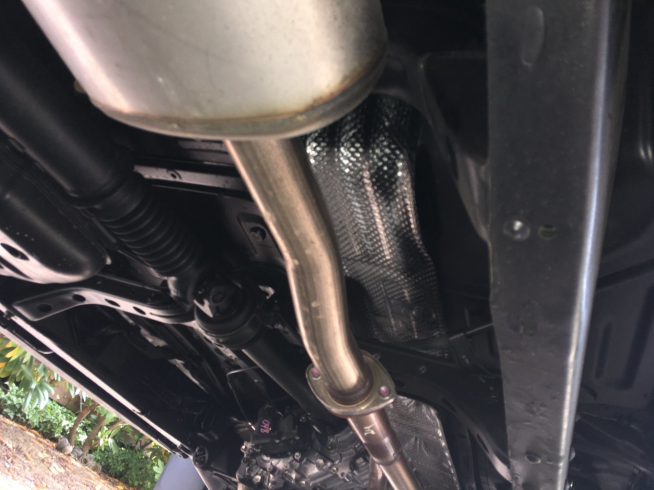

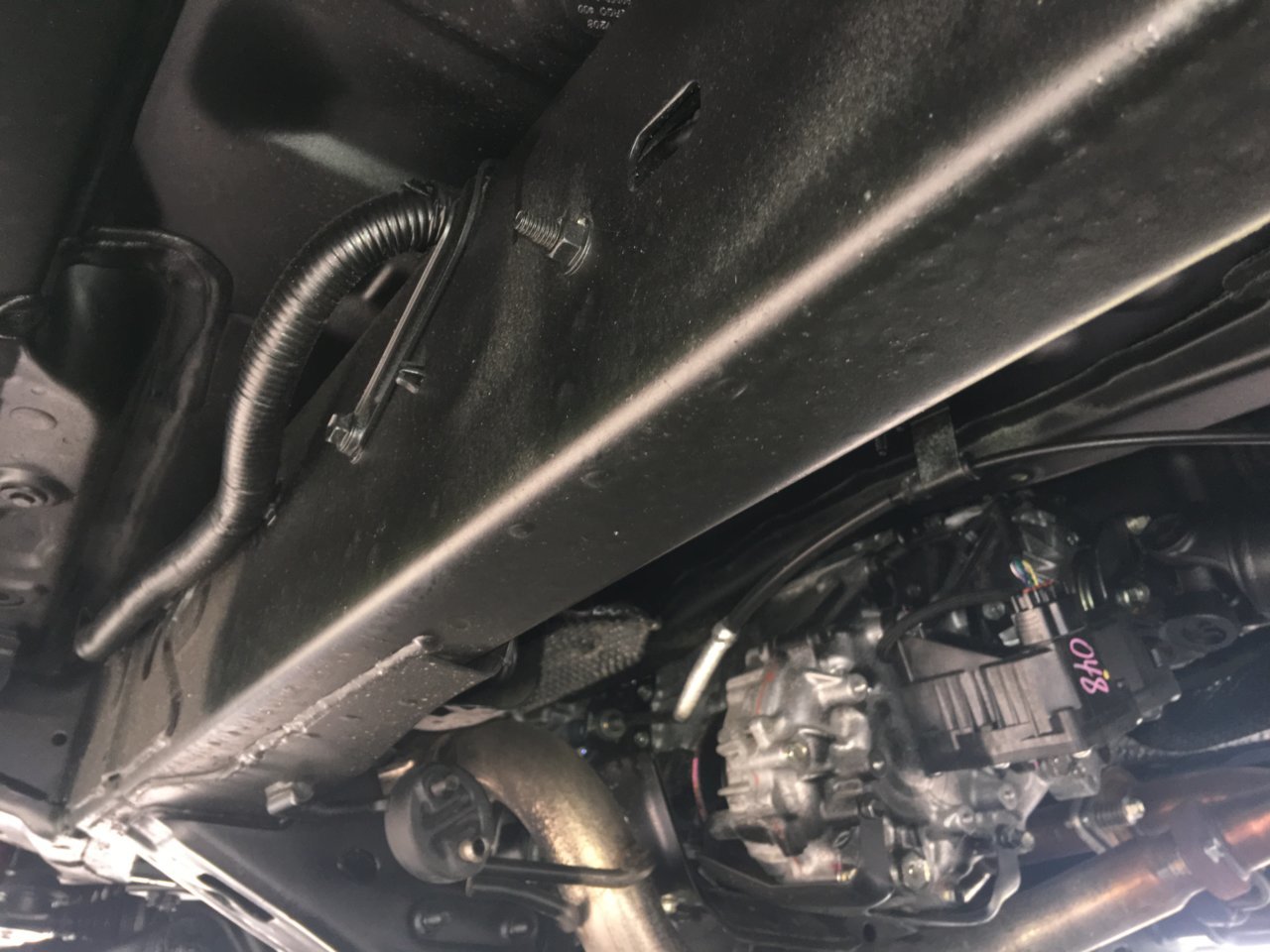

    2020 TRD Pro in May....I did the RP-342 Black cosmoline first thing. In NE Ohio they use nasty chemicals on our roads and this thin built Taco would be shredded in no time.
    I used the black instead of clear to see where the application was going, This stuff does NOT wash off, you need thinner or similar to remove it.
    As for attracting dirt/dust...not so much it does have a waxy feel to it though.
    I did it outside because of overspray and smell. do not do it on a windy day it gets everywhere. I also would do it on a dirty truck not on a freshly washed truck. I would immediately wash the truck to get off overspray.

    For those of you that have used this product in black; is the black tint translucent or opaque?
  11. Sep 27, 2020 at 3:46 AM
    OverlandExpress
    OverlandExpress Well-Known Member
    May 24, 2020
    #329187
    398
    NE Ohio
    2020 Taco TRD PRO
    scope out my pics above. it is solid black

    Yep, I checked out the pics. Black product on black frames doesn’t really tell the story but I see your floorboards are pretty dark. Just wanted to double check.
    Looks good man. Did you use the little tube?
