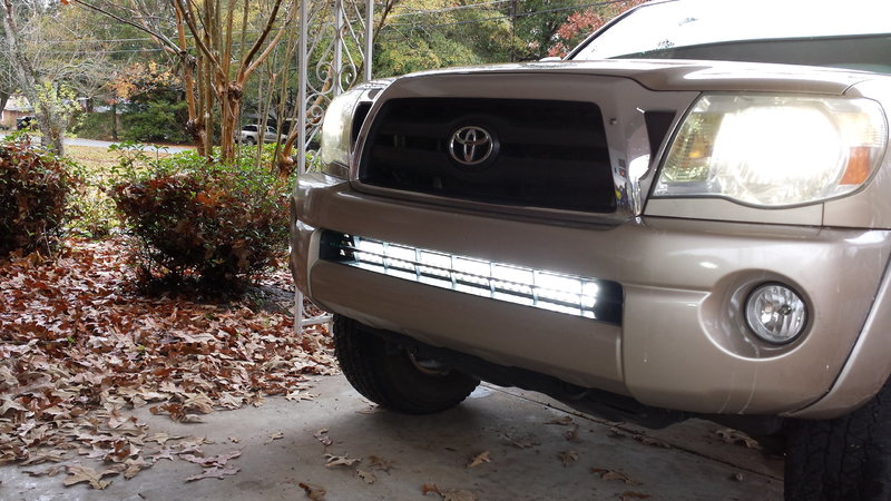

    Hardware and construction looks identical to the generic branded bar I bought off Amazon for 1/3 the cost. CREE emitters are industry standard. Their website says 30* deg spot pattern - but you can clearly see that the outboard sections has different reflectors than the middle. Probably more of a flood/spot combo. I seriously doubt this is a true Rigid competitor considering how much it looks like the china made generics. 3 year warranty if you buy it through RC or a RC vendor.

    I don't know that I could get the mounting bolts drilled in where they needed to be on the crash bars with the bumper in place. You can get the light bar in place with the bumper on, but there isn't much room to work with a drill.
    I took all of mine apart and drilled/tapped the crash bar arms for the mounting bolts directly. Otherwise, there's no way to get a backing nut onto the mounting bolts. I suppose a bracket could be made to allow it that could be bolted to the assembly, but I was fine with my method.

    I did a write up on my Rough Country install (Kinda crappy write up but you should get an idea of the process)https://www.tacomaworld.com/threads/rough-country-30-led-with-hidden-front-bumper-mounts.388378/.
    I didnt have to remove the bumper but the 7mm end bolts were tight and I used an end wrench to tighten and adjust the light.
    The picture I've attached is the Rough Country installed with my winter driving covers over the light bar (Westin, single row, amber light covers).
    The RC is a single row light that provides decent lighting for what I use it for; mainly looking out for unexpected pot holes and rocks getting to duck hunting places in foggy weather.
    Because it is mounted in the lower bumper valance the light projects straignt and flat but really does not illuminate the front "corners".
    The 3" cube lights (also in winter driving amber) are Baja Designs, Squadron Pros in their new amber wide cornering lens. (I'll get the clear wide cornering lenses for summer driving later). The BDs compliment the single row RC light bar nicely and because they are higher in the grill, the BDs throw out plenty of light than compensates for the areas not illuminated well by the RC single row light bar. http://www.bajadesigns.com/ProductDetail?ItemNumber=490003
    If you are not a serious off roader like me and need extra, but not dominating light, then the RC single light bar will do fine. I was not all than impressed with the fit of the RC bumper brackets (I had to hog them out to get them to fit my 2015 bumper mounts) and the knowledge of the customer service for my single row amber light covers was pretty bad.
    Other than that, the RC is ok for the price.

    Now - I wasn't aware that RC made a special mount for our trucks - that does sweeten the deal a little, but still not $200 better. I agree with Chet's opinion of the output - my china-clone does put out a lot of light, but not a big focused beam like I used to get out of my old 6" procomp 100W halogens.
    I also wonder how much having the light mounted down that low, and recessed into the bumper opening is affecting overall spill and throw. I did not cut my "fins" in my bumper, as my light is mounted just behind them.

    I was lazy and just cut my fins...took about 15 minutes with the dremmel. The crash bar mount is a lot cleaner look but I'm sure I would have screwed something up trying to dismantle and install the light like Chris did.
    I really like Chris' double row lights and the light patten it throws. The RC is a straight spot beam pattern which is probably why it doesnt illuminate the front corners as well.

    photo of my RC light bar installed in the lower bumper20151023_143509_Richtone(HDR).jpg

    Mine isn't rough country it's a knock off from Amazon but it looks the same. I used the rigid brackets to mount to the crash bar.

    I had some issues with the size of the "hidden bracket" bolt holes that slip over the threaded 14mm bumper mounts. You may want to check that out for fitment first thing and be prepared to enlarge the holes on the hidden bumper mounts.
    The RC install guide recommends a sawzall type saw to cut through the fins which I did not feel comfortable using because of the way my sawzall jumps around...maybe a short blade will work but I didn't want to risk damaging the inside of the lower bumper cowling.
    Make sure the damned end bolts fit into the light bar right after you unpack everything. One of my end bolts would not thread properly once I got everything put together in the lower bumper. Everything is a tight fit so trying to insert, thread and tighten the end bolt containing a spacer, flat washer and lock washer once the light bar is in is a PITA.
