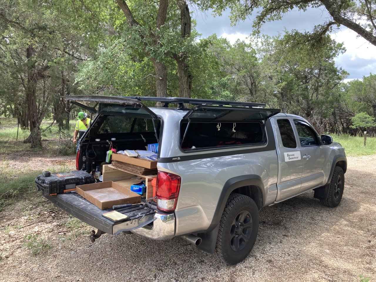

    I recently acquired an ARB Aluminum Flat Roof Rack Mesh Part# 4913020M on Craigslist. Its brand new and has all the mounting hardware to mount onto a Lexus SUV. I want to mount this onto my A.R.E. Overland Camper Shell (Longbed). The camper shell will arrive in late May but I want to have a plan in place. I plan on using the roof tracks that come factory installed by A.R.E.
    I reached out to ARB tech support and they told me they could offer no advice whatsoever because they do not have kits to mount onto camper shells.
    Does anyone have any advice on what to use to mount this rack? I don't want to add the skyline towers due to height concerns. I would like a lower profile, ideally 2 inches off the roof.
    How do your roof racks attach to the camper shells?

    Never updated this. Here are the photos. I used some Sherpa adjustable mounts. IMG_3033.jpg64547025704__11DBCFA6-2AFE-4433-9BFA-3BF6569A7CBF.jpg IMG_3261.jpg
