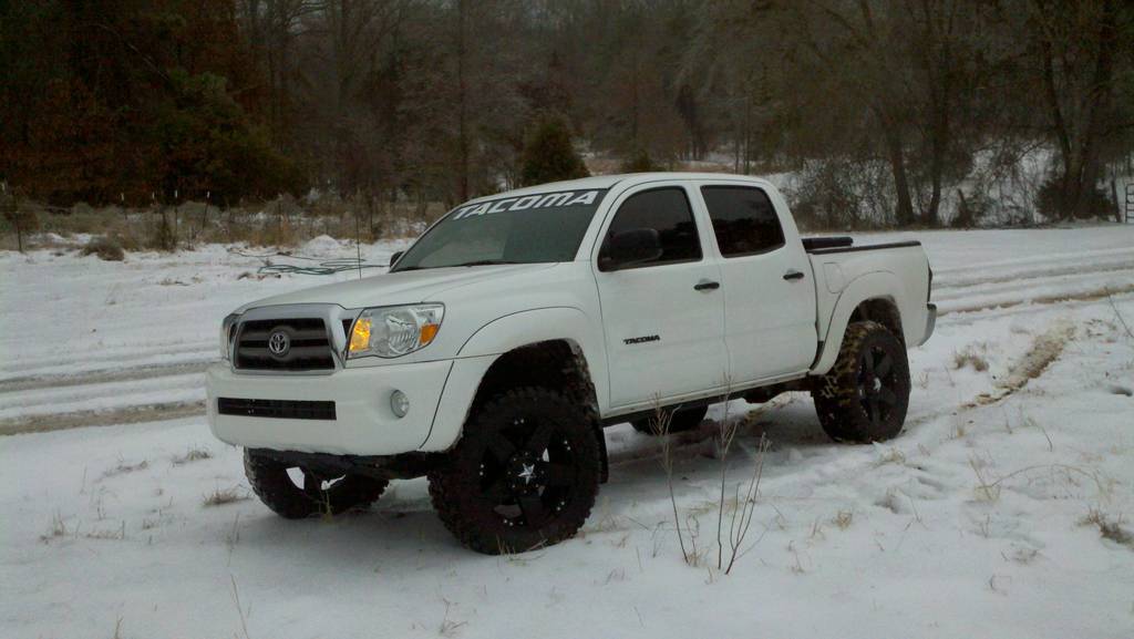

    i havw prob comp 3 inch lift with 20's and 33's....the scurb the mud flap but they were riding along the UCA until i got a .25 wheel spacer.....mine are 20x8.5 and that is what you should get but it is your truck
  9. Jan 19, 2011 at 3:25 AM
    francis1291
    francis1291 Well-Known Member
    Sep 27, 2010
    #43911
    1,160
    10 4x4 SR5 super white
    3" procomp lift wit 20" rockstars on 33 toyo mt's
    here is mine..............[​IMG]

    im kinda confused? What are you saying? I have 33x1250x20 and all that srcubs is o the mud flap but i had to add a 1/4 wheel spacer. my tires stick out past the fender flares
