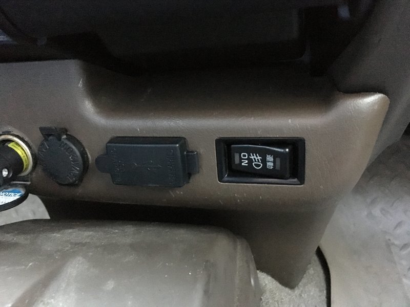

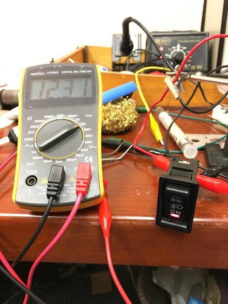

    I'm in the process of adding some LED lights (front / rear) and I need a good clean looking spot for the switches. The ideal place is the factory cover that's below the ashtray and holds the two 12V power outlets - there are two blanks there that can be popped out. Anyone know of switches that can snap into those spots without ripping up the area? Ideally 3 pole switches that will trip a relay for the lights.

    That's usually where the RS3200 Toyota security system glassbreak detector would go. They fit OTTRAW switches with minimal filing to the plastic.

    I wired my pod lights up to a switch, that's where I ended up putting the switch. It fit perfect.

    Do you know the brand / model of the switch you used?

    I can confirm. Fit like a glove

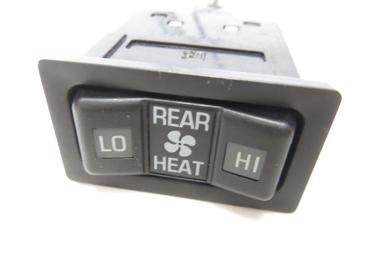

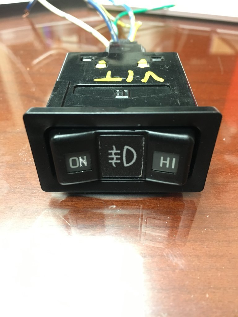

    Defrost mirrors, compass/temp display rear view mirror, rear wiper on camper shell, trans.cooler.
    I used a Kia Defrost switch. It is just a bit short for the hole. It does have a light indicator and a backlight that comes on when headlights turn on.
    You could probably take an ECT switch or Clutch Cancel switch apart and change the name?

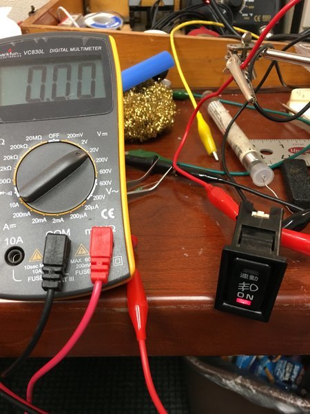

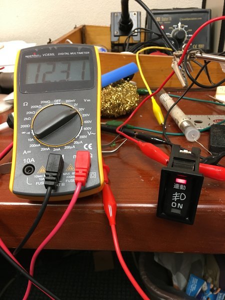

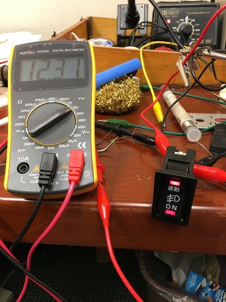

    I confirm that. Cheap China stuff. Can get stuck from time to time. I modified it's internal connection for what I wanted to have (back-lighting changing from white to red when pressed) and as much as I wanted to make the mechanics better, there is nothing I could do. But I have it as a rear fog light switch (the thing that is required in Poland) so I engaged it so far twice here - on safety inspection.
