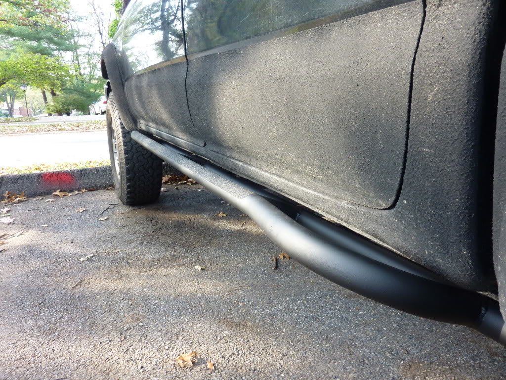

    Here's something. Check out these rockers. Not the most glamorous, but a FAR cry better than mine. Anybody know how that's done or if it is a purchased thing?
    GQ7227 and Taco critter like this.
  5. Apr 19, 2019 at 8:56 AM
    Kwikvette
    Feb 27, 2019
    #284735
    79,562
    Fresno County
    4 run, 2 don't
    Looks like bed liner.

  13. Apr 19, 2019 at 10:39 AM
    testelle
    testelle [OP] Well-Known Member
    May 23, 2016
    #187689
    910
    Todd
    Oley, PA
    2003 Red 3.4L 4WD DCSB
    OMG that might be the very truck I posted the picture of earlier today
    dschreib and Taco critter like this.
