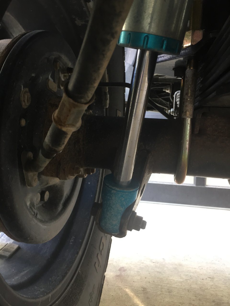

    So I am in the process of doing my bi-annual service, and I'm starting to notice some nasty rock chips in the shafts of my rear shocks, the passenger side is the worst, with it facing forward. It looks as though none of them are within the travel range of the shaft, but the drivers has two that are right in the mid travel of the shaft, and I'm worried that it may take a seal out eventually. Is there any alternatives to guarding the shafts from rocks, other than neoprene boots? Is there a metal or plastic shield of some sort? Or is neoprene the best option? Shocks are 2.5 king resi's

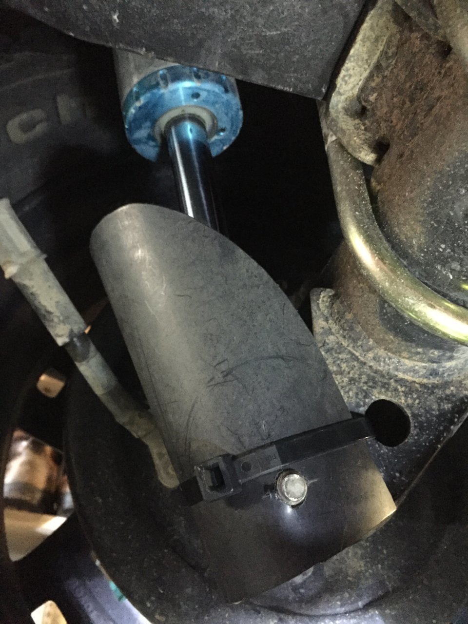

    I had the same issue - freshly installed kings already getting pitted on the rear passenger side. I made a guard from an old flower pot and a heavy duty zip tie. Seems to do the trick for now!

    what kind of material is that flower pot? im looking for more protection for the archive garage lower mounts. i really like that yours goes all the way around and protects the end of the shock not only the shaft. Maybe i can bend some aluminum and squeeze it in there

    It’s probably HDPE or similar. I ended up getting the King guards since my own DIY job wouldn’t stay in place for long periods of time on rough roads. The King guards were garbage, both shattered quite quickly - not sure what kind of product testing they did on them but they don’t do what they are supposed to. I now have a boot on the passenger side and a pitted rod end.

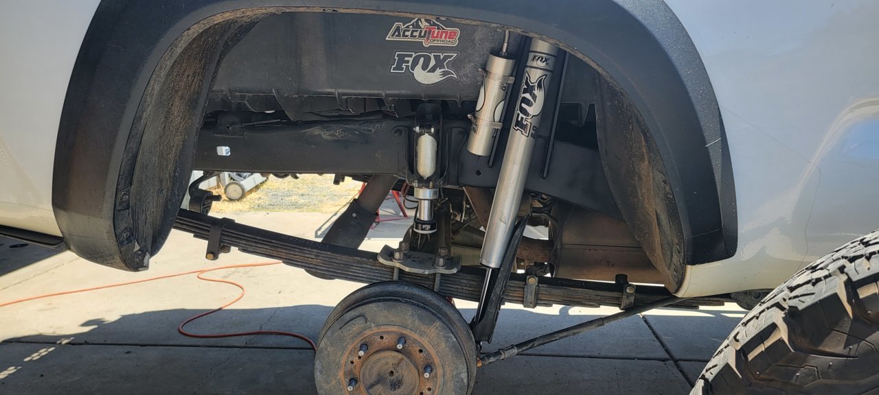

    Those look interesting, but I think they are for 2.0 shocks only?

    Both of those are made for 2.0 shocks and will probably interfere with any 2.5.
    I have some 2.5" boots that work ok but still let crap in around the shafts.
