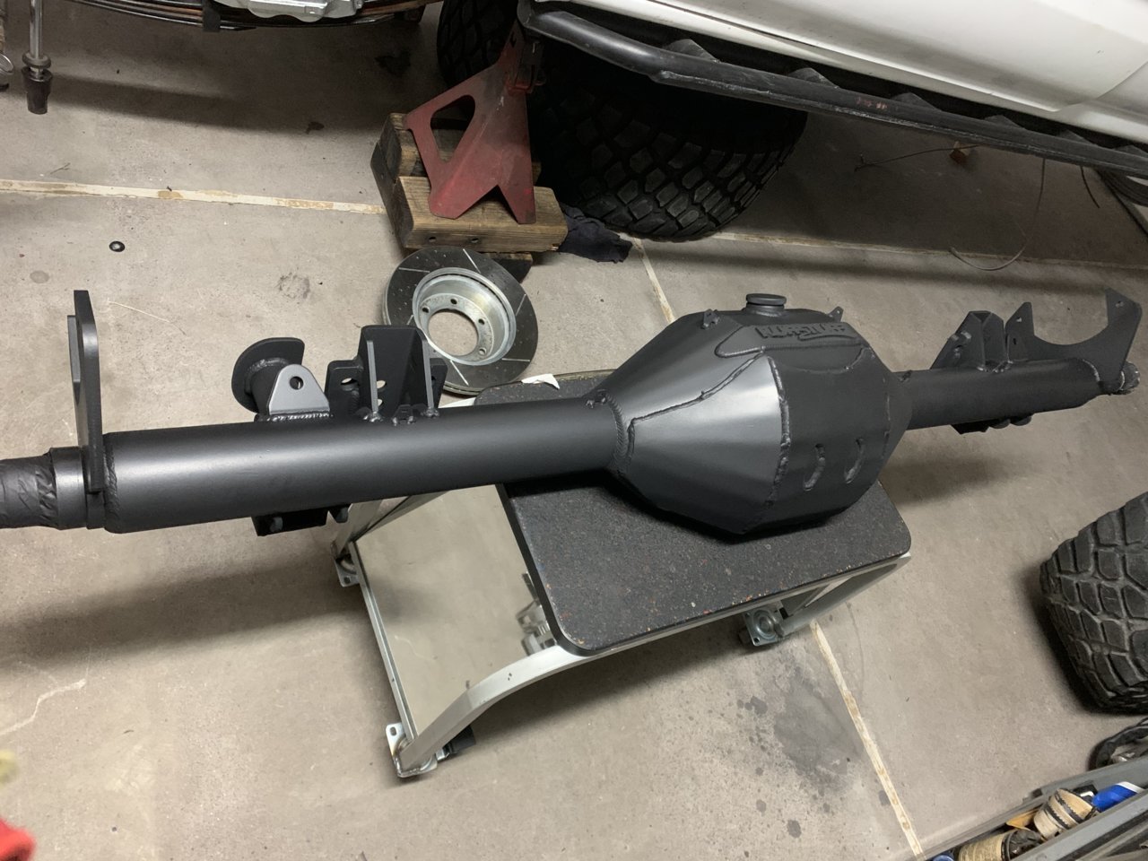

    Every Toyota guy will tell you diamonds but wait times are ridiculous from them and I had some pretty bad experiences with them. Both trying to order and at off road shows/vendor shows at crawling events. I’m biased but have been extremely happy with my ruffstuff housings. Best bet is to call and talk to someone. They walked me through the ordering and gave me shaft measurements while they finished it so I could order shafts a head of time.
    The new trail gear 8 in housings look nice as well and if you have a way to keep it straight I wouldn’t hesitate to go that route. they’re 9 in housings have a great reputation in the comp crawlers and ultra 4 scene.
    Some axle porn for you.
    648E7341-D067-4BB9-871A-BB10531999CF.jpg 1C07EF0F-C4A7-4BFA-A68B-E57CA55187DE.jpg 3C4A4703-FAB8-4DF2-AE71-3456C1602B23.jpg
    If I wasn’t so desperate to wheel and over building I’d consider selling my 8 in mini truck front but it wouldn’t be cheap.
