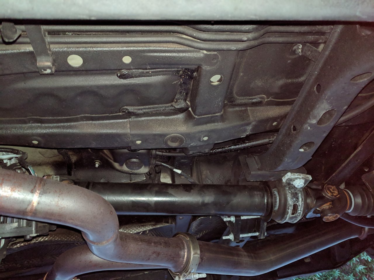

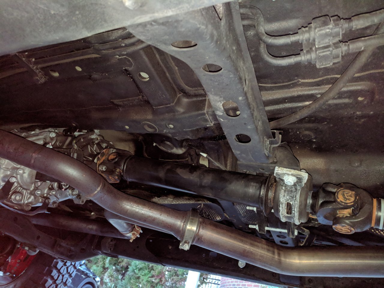

    I used 3m professional rubberized undercoating. I used 7 cans to coat the bottom of the cab and went about 3 layers thick all around. Helped a LOT with road noise and tire noise, everything is much quieter after that. Cans are 10$ and some change a piece at Autozone but it works really well. I used the same paint for my sliders and have slid on the sliders and the paint survived that, FWIW. The stuff is TOUGH

    Sure thing. This is taken earlier tonight.. about a year and three major snow storms I drifted through after I installed the undercoating! It's tough stuffIMG_20180129_174726.jpg IMG_20180129_174904.jpg
    Bridge4[QUOTED] likes this.
