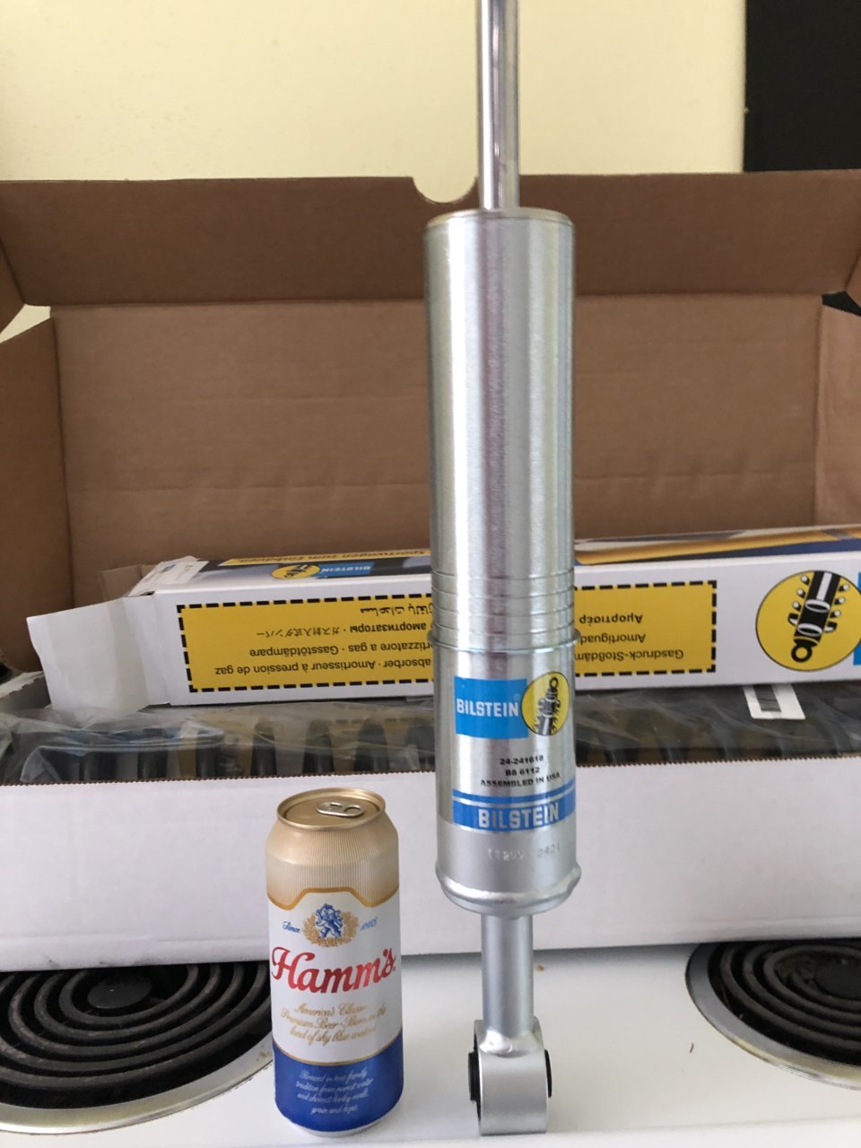

    I ended up going with the 6112’s for the front and I’ve got some B110’s (I’ve got Dakar EL095R leafs) and supporting mods coming for the rear. Picked them up on RockAuto for $603. Just installed the front today. Not gonna lie, I’m stanced like a bro-dozer right now till the rest of my lift comes in. Luckily I’ve got a lifted beater Subaru to drive till then!! I know these are no 8112’s (my dream setup) but for the price they will be more than I can use. I have no desire to go King, Icon or Fox since I won’t use them to their ability. Not saying they aren’t great, just not worth spending that kind of money at this time in life.
    These 6112’s are no joke though!! Yes it’s Hamm’s, yes I love Hamm’s (get off my back hipsters) and that’s a 16oz tall boy for comparison!!!
